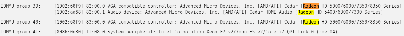

Come to think of it, it's possible that many of the VM problems I've had were related to devices in that slot.  The non-working card is group 40 below, o it's in its own.  I had heard of the override patch but never used it, will it make a difference if its already in its own group?

No. It only helps if you have like I described earlier multiple different devices in the same group. In your example group 39 is the same device. You have to pass both to the VM to make it work. Not passing through the audio part can lead to issues with the VM.
Group 40 in your screen is this another AMD GPU? Do you have 2 exact same models in the server or are they different? I wonder why it's not showing an HDMI audio controller as well. If it's the same generation it should show similiar results as group 39. Without ACS the audio part should show up in the same group as the card. Is there any other group maybe with the HDMI audio controller?

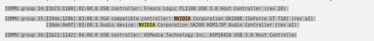

Yes, they were both the same gpu chip but different cards. the second one is dual DVI only, no hdmi therefore no audio.  In any case I first shuffled things around with that card in a different slot and got the same result.  Then I tried to go back to the nvidia gt710 card in the new slot, passing through both its video and audio addresses and it outputs video but uses the microsoft basic display driver. nvidia driver installer doesn't see it.  That XML error only comes up when I try to pass the card to the Ubuntu VM, no devices match those numbers.
Here are the new groupings:
Here is my passthru line from the flash drive.  All the other devices are working fine in their respective VMs:
kernel /bzimage
append vfio-pci.ids=1b21:1142,1912:0014,1b73:1100,10de:128b,10de:0e0f initrd=/bzroot
Diags attached
unraid-diagnostics-20191119-1442.zip

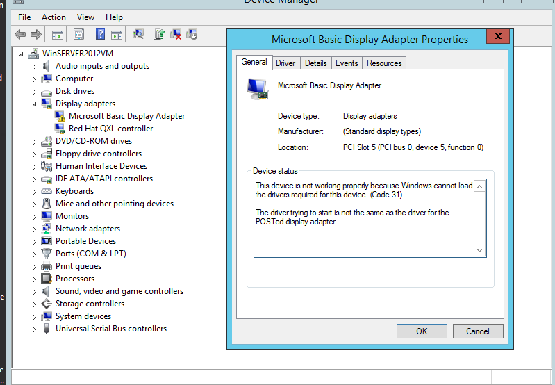

Well, this is new, but unfortunately I'm apparently the only one ever to have gotten a code 31 in the entire UNRAID Forum universe.  This is the Nvidia GT710 with both audio and video stubbed. Anybody reading this stuff?
unraid-diagnostics-20191121-0308.zip
@btrcp2000 This is a normal scenario if you have also the VNC adapter connected to the VM. The dedicated GPU shows up as Generic Microsoft Display Adapter and the driver install often fails. Configure remote software like RDP or Teamviewer, make sure you can connect, attach a display to the GPU, remove VNC and test if it works.
Yes, I've seen that before but tried again just now for good measure. It outputs video, but uses the Microsoft driver. Mfr GPU driver installs don't recognize it
