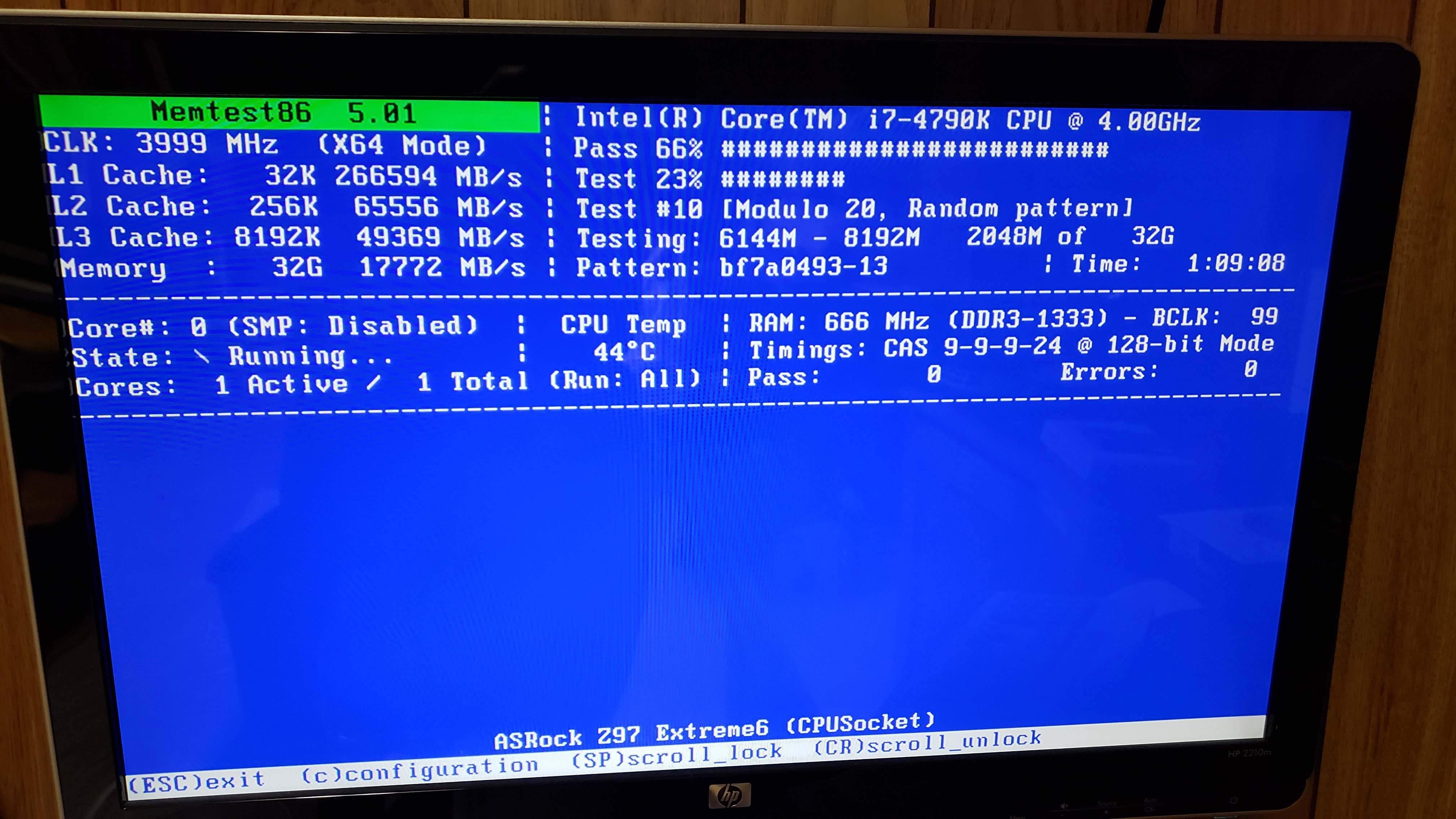

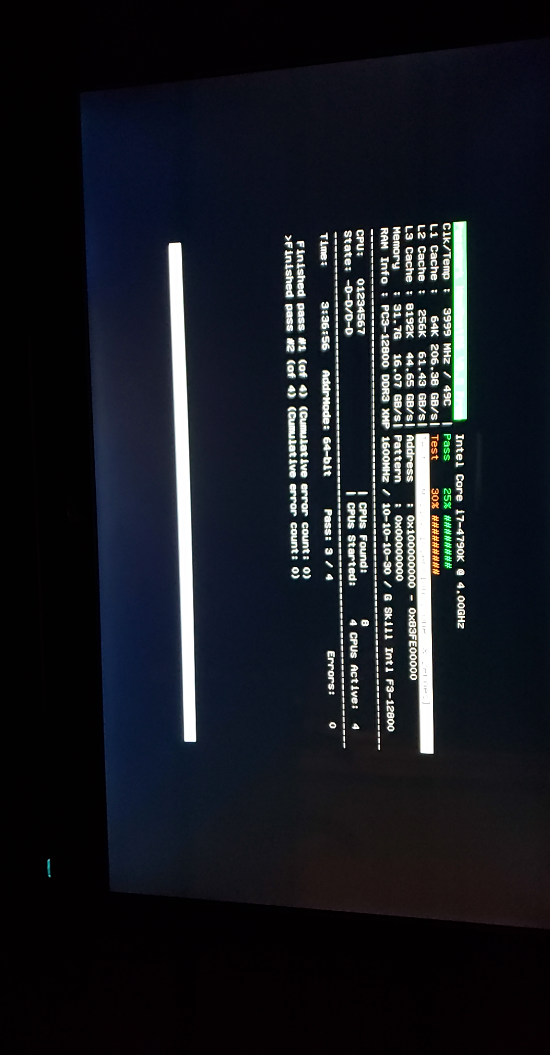

For what it's worth I have been running Memtest86 for over an hour now and here is what I have got so far.
Ok so I did 1 run using memtest86 version 5.01 and got no errors. Then I stopped it and tried version 8.2 of memtest86. I am currently done with 2 runs of this version and have no errors. I will let it finish overnight and update in the morning. It has been taking about 1 hour 45 mins per run so I am a little over 5 hours of memtesting.
