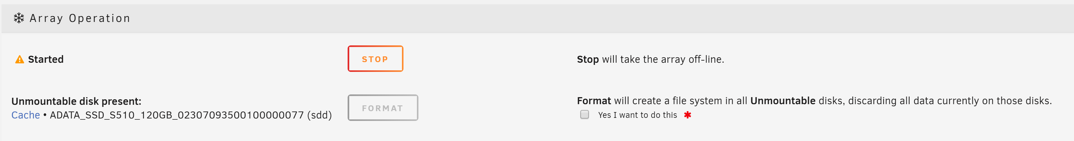

Now the old cache drive now shows as unmountable, no UUID
Now I see this:

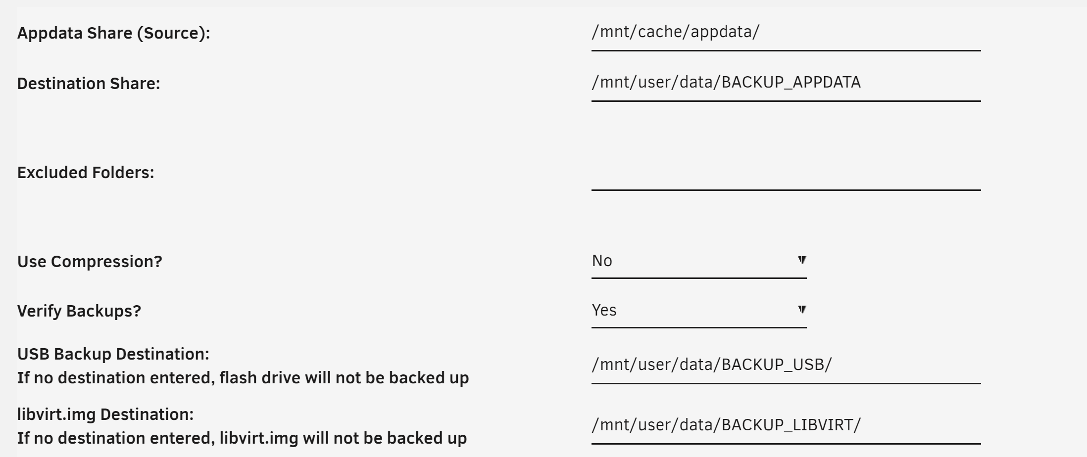

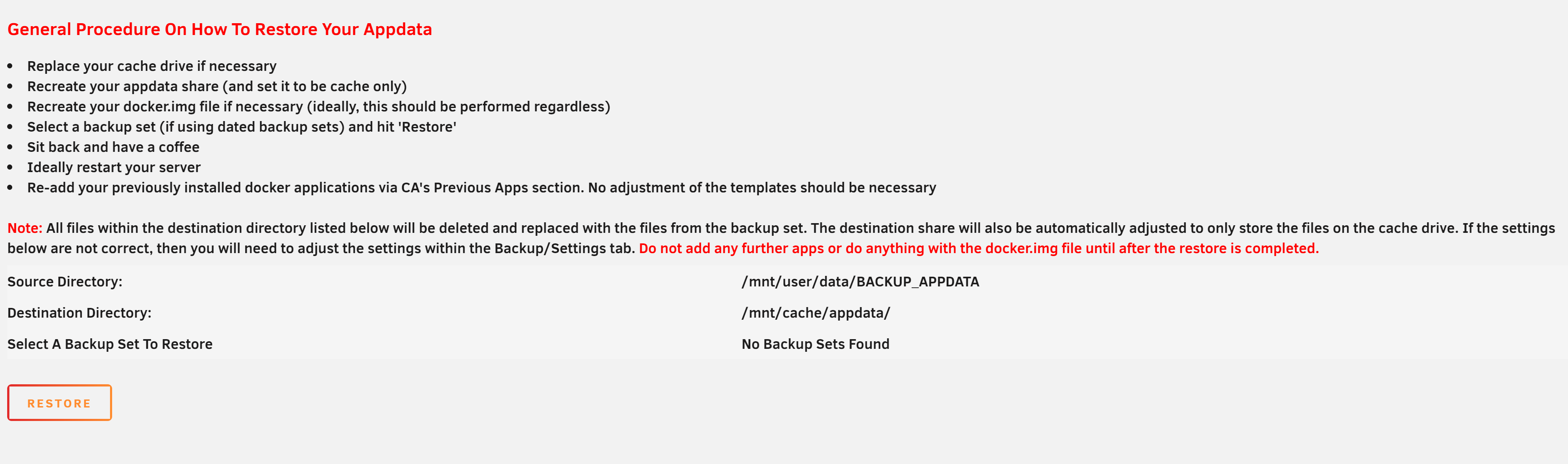

I really don't need the old SSD. I was planning on copying over everything from the old SSD to the new SSD. But now that I wiped the old cache drive, I'm not sure what the best recovery path is. I have the backup, but not sure if I should restore to the old SSD or the new one. Also not sure if the backup will have everything I need to restore the original cache files. Here is the CA BACKUP setup I had:

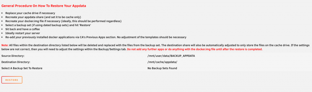

And here is what shows in the backup plugin under the Restore tab:
When I read this Restore page I went to the Shares tab and saw that all my shares were gone. I'm assuming they were part of the cache setup.

Having all your shares "gone" is likely due to the USB stick corruption you had and not because of your formatting of the cache drive. This is assuming you have at least some shares with Cache = No (or Cache = Yes and you have already run the mover in the past).
Now, the reason you have "No Backup Sets Found" is probably because you set your data share to either Cache = Only or Cache = Yes so the backup was already erased by your formatting of the cache disk. (in the case of Cache = Yes, you might have formatted the cache before running the mover so the backup is still in cache).
So unfortunately I don't think your data is recoverable.

I guess what I don't understand is that I watched the backup complete and it was set to back up to the a folder called BACKUP_APPDATA on a share called DATA.
Shouldn't that still be there? I mean, assuming I can pull the HDDs and read them individually, I would expect to find that BACKUP_APPDATA folder on one or more HDDs with the files that make up the backup spread across them.
In other words, it's not breaking individual files into multiple parts across drives is it?

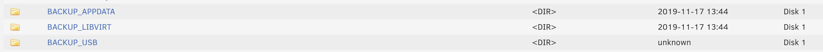

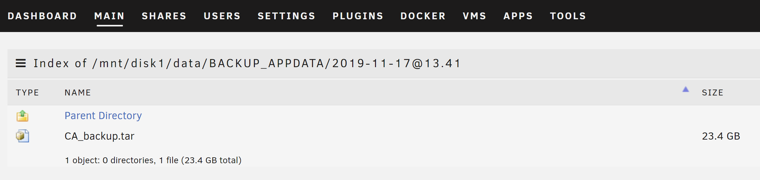

So here is what I see:
DRIVE 1
the other 2 backups are also here, but the one for BACKUP_USB is empty

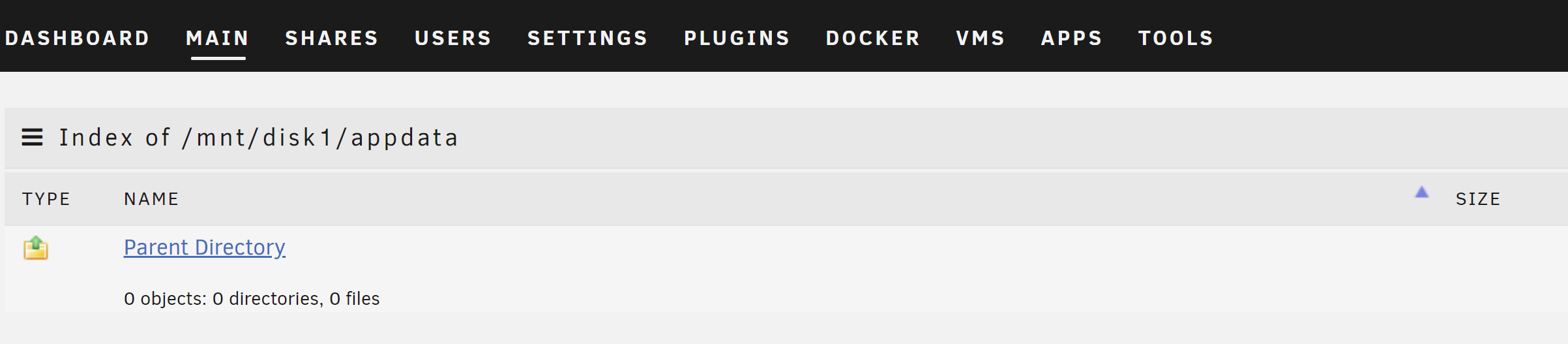

and there is an empty APPDATA folder here:

Procedure is to hit the restore and then select the backup set.  If it's not finding a backup set, then there's something else presumably going on and it's probably due to the unmountable cache drive and you should post your diagnostics
Thanks. I can do that tonight.
Just to be clear, there's no problem hitting restore and pointing to the new Cache drive I put in? (assuming it can find the Restore Set)
A restore is the opposite settings of the Backup.  IE: You set the plugin up for how to backup, and don't change anything when you want to restore.  It'll figure it out.

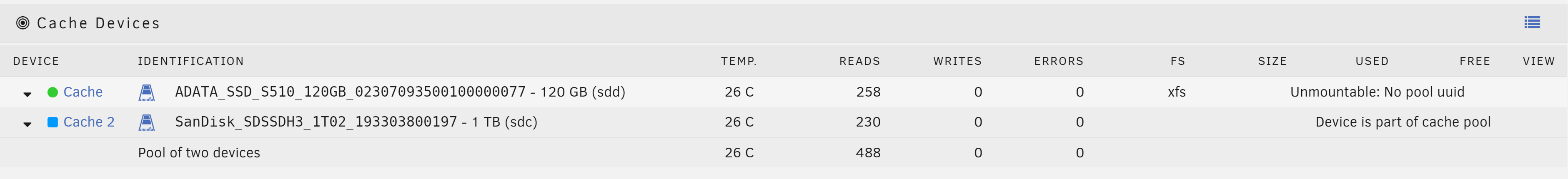

I've got 2 SSDs now:
  • The original SSD cache that I wiped and is now unmountable
  • The new SSD - which hasn't yet been used as a cache drive - that is mounted and ready to use as cache.
When you say "don't change anything when you want to restore", does that include the SSDs?
Yeah, as far as the Appdata Backup / Restore plugin is concerned, nothing changes.  If you're changing the SSD, then you do that, create your appdata share appropriately and run the restore
