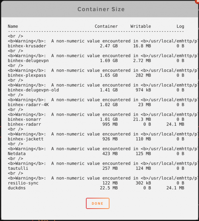

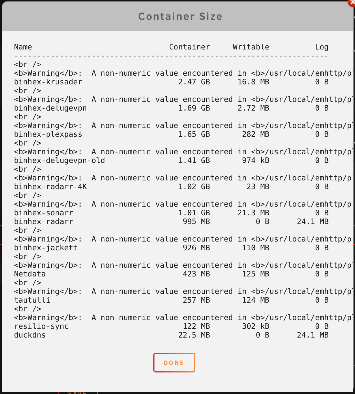

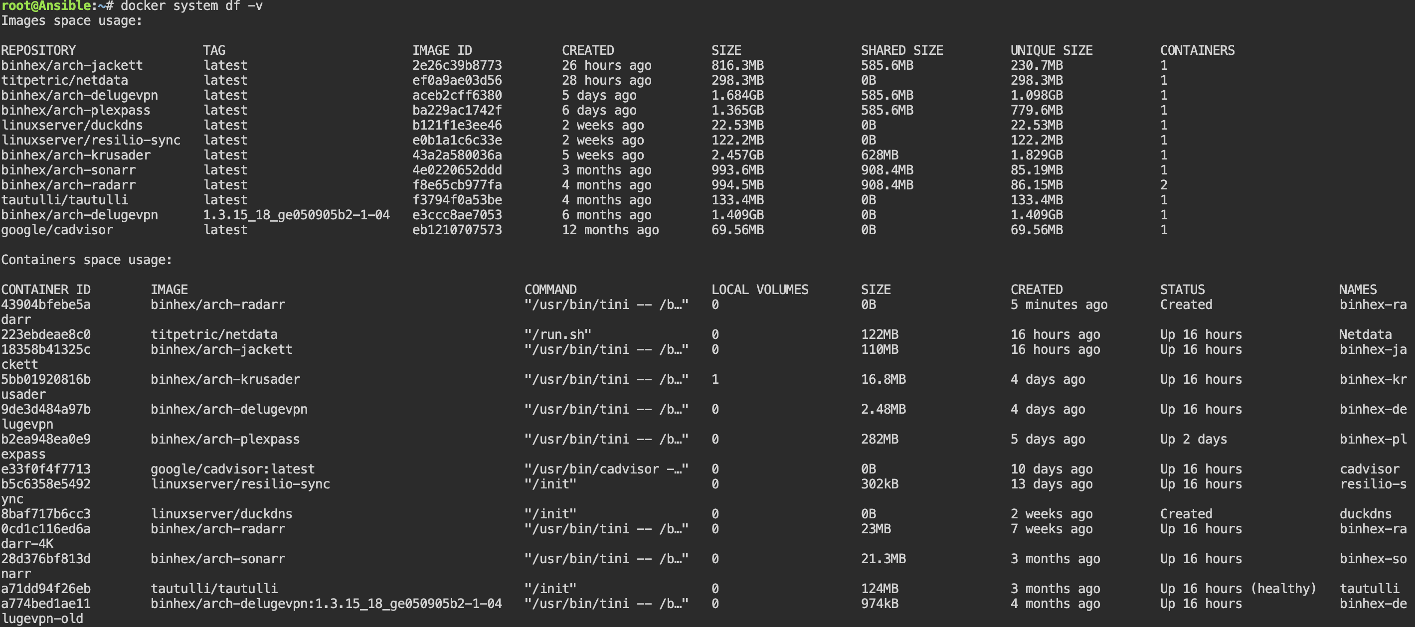

Been driving myself a bit crazy trying to determine what is filling up my Docker.img - I've already increased the size of the image way more than I should have and am still struggling (91% of a 65GB image file). I've attached the results of the container size button on the docker tab, the results of running docker system df -v, and would much appreciate any help you could offer.

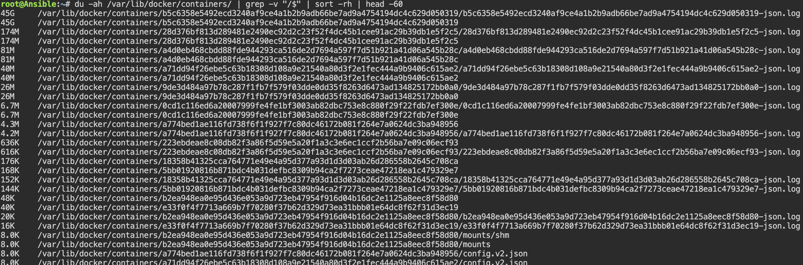

In my search to determine the culprit here, I ran this command du -ah /var/lib/docker/containers/ | grep -v "/$" | sort -rh | head -60 which resulted in the following
 1004802464_ScreenShot2019-11-19at7_14_08PM.thumb.png.e4f4e4ff9934f6efc1b2597c00e2643a.png
I then ran find /var/lib/docker/containers/ -type f -name "*.log" -delete which seems to have deleted the 45G files from the above picture, but the docker image utilization hasn't changed. I'm pretty desperate for help at this point.

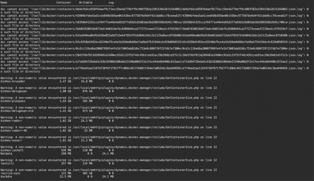

Can you post the output of
php /usr/local/emhttp/plugins/dynamix.docker.manager/include/GetContainerSize.php
Errors should not be happening on that first screenshot..
Edited by Squid

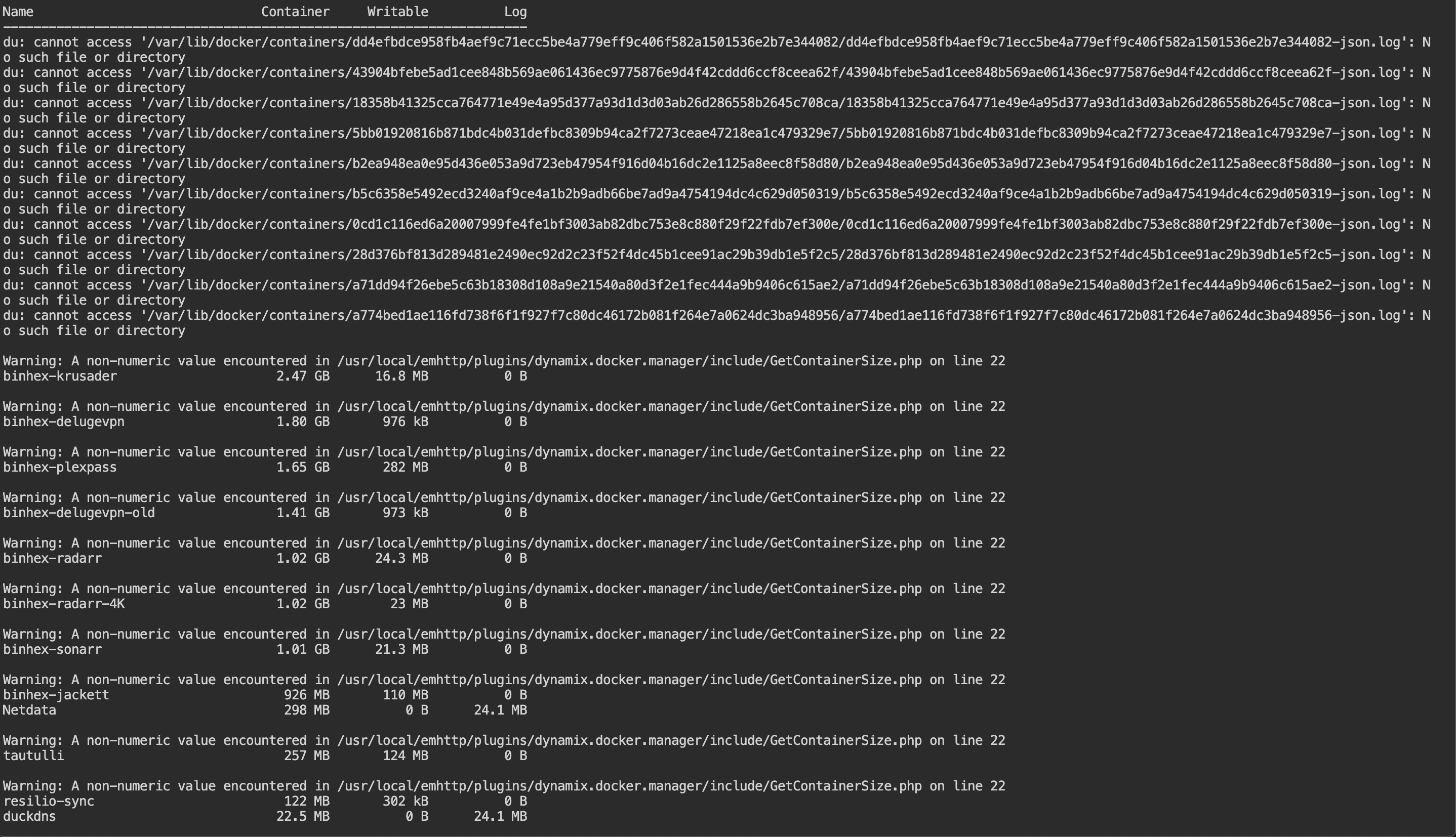

Seems like the problem is not fixed as I had to go through the same process today109820407_ScreenShot2019-11-20at5_29_38PM.thumb.png.d6c9ba9a6933c3bac0bfec39b81665b0.pngSee above for results for the php command
Forgot to be more specific in previous post, the exact same 45G file showed up in response to du -ah /var/lib/docker/containers/ | grep -v "/$" | sort -rh | head -60, so I followed up by using the same find /var/lib/docker/containers/ -type f -name "*.log" -delete that seemed to work (temporarily) yesterday. These two commands were run before I posted the output of the php command.
