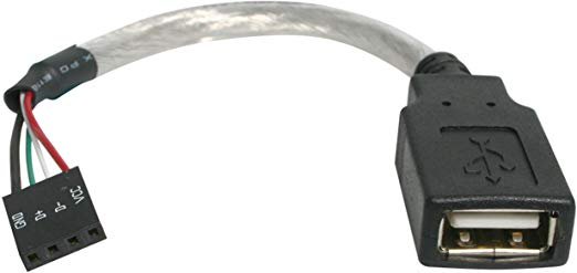

2 hours ago, Faspina said:
stick out from the front of the tower server.
That can be pretty easily fixed. Get a USB header adapter and put the key inside the case.
