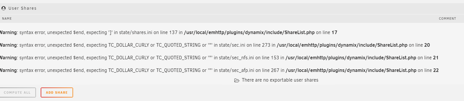

I fat fingered a docker path setting up a route to a folder ("/mnt/user/[share name]\"), and now I have a "\" share. this breaks all sorts of things, and I get an error message hidden under the header of every page of my UI, which breaks a lot of functionality. I can't find a way to persistently remove the share in the .ini files in /var/local/emhttp/plugins folder, which is the only such files I can find. I've uninstalled all the dynamix plugins I had, so I don't even know why the template.php is rendering.
Warning: syntax error, unexpected $end, expecting TC_DOLLAR_CURLY or TC_QUOTED_STRING or '"' in state/sec.ini on line 273 in /usr/local/emhttp/plugins/dynamix/template.php on line 25
Warning: syntax error, unexpected $end, expecting ']' in state/shares.ini on line 137 in /usr/local/emhttp/plugins/dynamix/template.php on line 29
Warning: syntax error, unexpected $end, expecting TC_DOLLAR_CURLY or TC_QUOTED_STRING or '"' in state/sec_nfs.ini on line 153 in /usr/local/emhttp/plugins/dynamix/template.php on line 30
Warning: syntax error, unexpected $end, expecting TC_DOLLAR_CURLY or TC_QUOTED_STRING or '"' in state/sec_afp.ini on line 267 in /usr/local/emhttp/plugins/dynamix/template.php on line 31

The UI for the shares is broken with the same errors, so I can't verify what shares it thinks it has.
While I can't see the '\' share in the shares config directory, it does show up in the log file, breaking my samba service

I can recreate this bug.  To get rid of this, using terminal window or console you should be able to see the share names like this:
v /mnt/user/
Maybe you will see a directory that looks like this:
If so you can delete it like this:
rmdir "/mnt/user/\\"
Might need to stop/start array afterwards.
that solved it, thanks!
Thanks! I just had the same error. I had run a script with too few double quotes. In the end I had a share with a backslash in its name. Removed the share and everything is fine.
