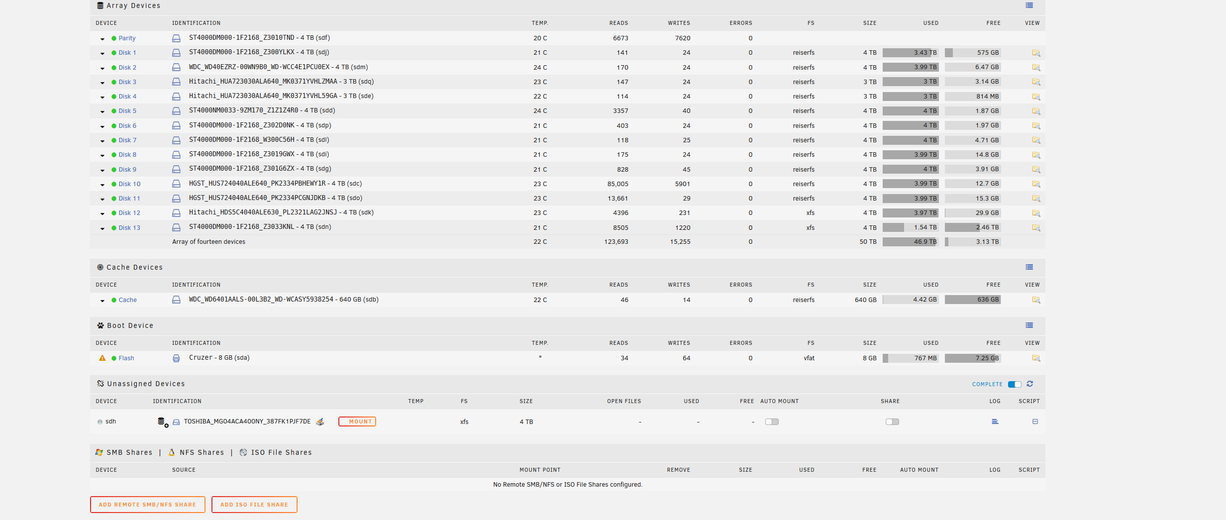

Nan b reading on a hard drive

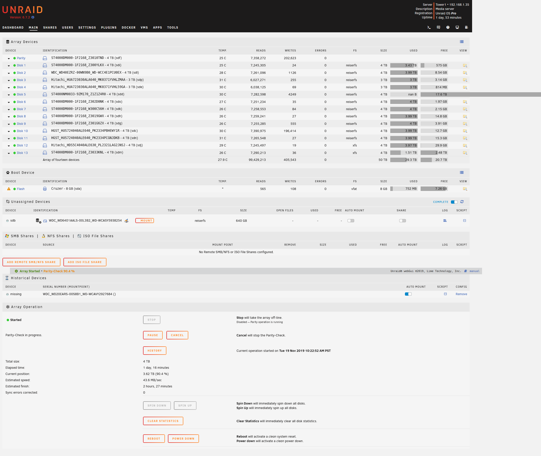

here you go I am running 6.7.2, a few weeks ago I have a drive showing a nan b. It is a 4tb drive and shows 17.6tb free.  I also get a warning on the drive from fix common problems :Drive mounted read-only or completely full. Begin Investigation Here:  Not sure what changes I should do. I replaced the drive but  still the same issue. I redid the drive config. still no fix. Doing a parity check but that's not fixing anything. Sorry for the muti images.image.thumb.png.98d59638c7eba72834350e0bbab2b9e4.pngimage.thumb.png.e314f906ca087cf9d1ea96441e5153bd.pngimage.thumb.png.e314f906ca087cf9d1ea96441e5153bd.png

well a update got the file check to run on disk 5 and the final result is: 39 found corruptions can be fixed only when running with --rebuild-tree
I got the check running now thru telnet. Its checking all disks. I have the next question will this program continue to run on all disks aka ones that are unassigned (not in the raid) but mounted.
thanks
humm trying to get a handle on this, guess it does not run all disks so, I am running on the md5 aka disk 5
The repair is only running on the specific disk.   Assuming the drive has not been marked as disabled (marked with a red ‘x’) then normally you only see reads  on the specified drive and writes to that drive and the parity drives.
if the disk is being emulated (or getting read errors) then you can will see reads happening on other drives as Unraid reads their contents so it can calculate what the problem sectors on the drive under repair should contain.
well that fixed it, next question is can reiserfsck  be run on a Unassigned Device if so what would be the command ???
I ran the rebuild tree  to fix it , not sure if I lost files but at least its not nan b
