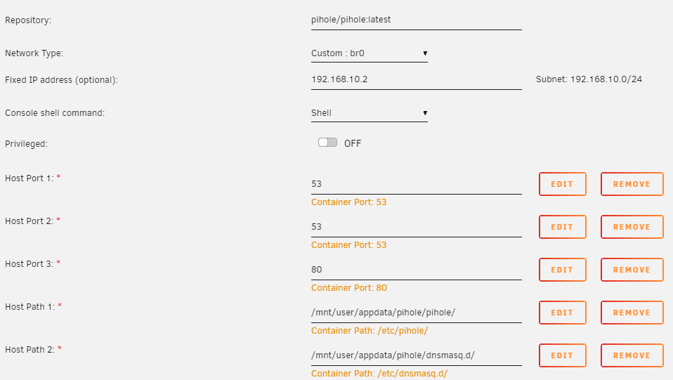

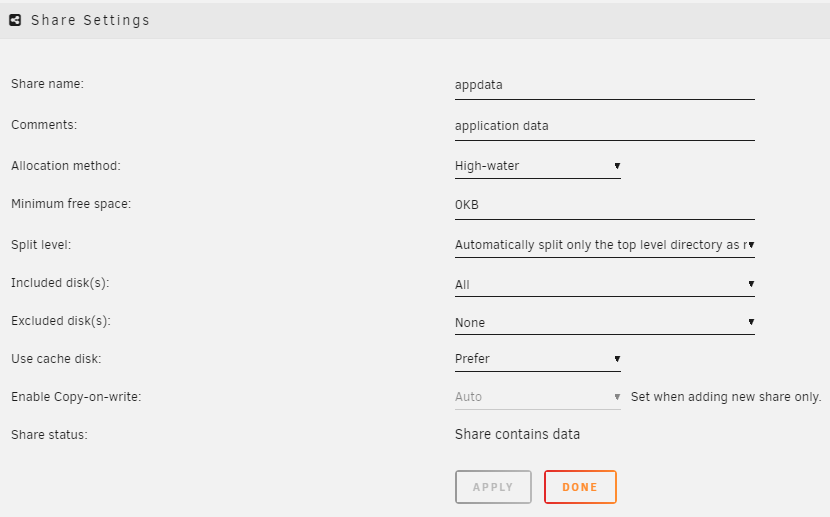

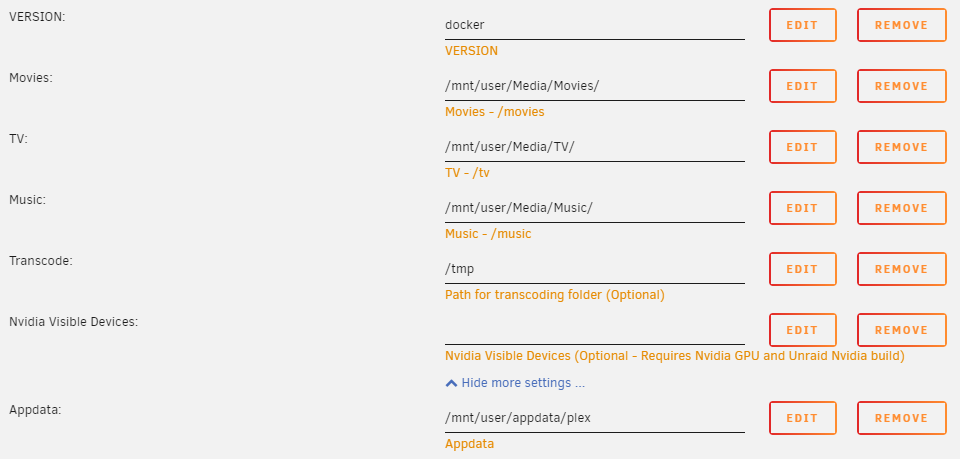

So just to be sure that I have my appdata, docker containers on the cache as you said... this is how I have it configured. Does this seem correct? I just want to be sure before I upgrade.
The appdata share: (does "Prefer" mean it's on the cache pool)
Plex docker container:
Pihole container:
Prefer means that if a cache drive is defined and present in the array that appdata will be stored there.  If you remove the cache drive(s)/pool or if the cache drive is full, appdata will be stored on or moved back to the array.  So, yes, in your current configuration, appdata is on your SSD cache pool.
