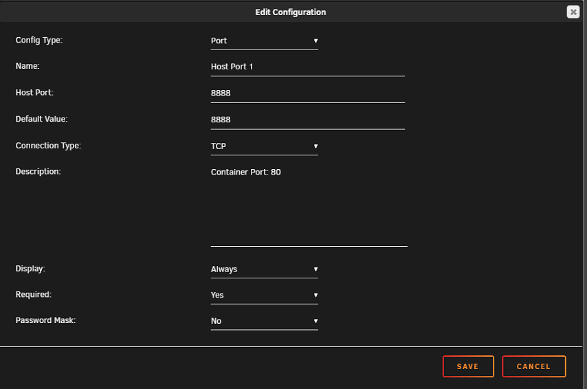

I've been having some issues for a while now when it comes to port mappings for Docker. Not with any one container, but usually most of them and all different containers.
I've found that Unraid isn't using the -p parameter at all, regardless of it existing withing the UI itself.
As you can see below screenshot, I have the host set to port 8888, however, in the command that is run it is not using the -p parameter at all.
/usr/local/emhttp/plugins/dynamix.docker.manager/scripts/docker create --name='H5AI' --net='br1' --ip='192.168.1.243' --log-opt max-size='50m' --log-opt max-file='3' -e TZ="Australia/Brisbane" -e HOST_OS="Unraid" -e 'TCP_PORT_80'='8888' -v '/mnt/user/isos/':'/var/www':'rw' -v '/mnt/user/appdata/H5AI':'/config':'rw' 'smdion/docker-h5ai'
Below is also the Template for this container, which looks fine imho

Port mappings are only relevant when you're using Bridge mode for network type.  For anything else the container can uses whatever ports it decides
You know what? Now that you say that it makes perfect sense! Duh! Thank you @Squid
Here I was thinking it was a bug. 😳
