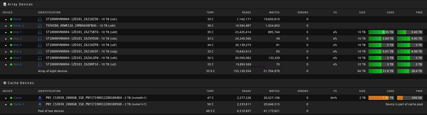

I use 8 drives, 7 of them are ironwolf and one Toshiba x300, they are all fast disks. additionally I have 2 NVME SSD as cache in the Raid1.

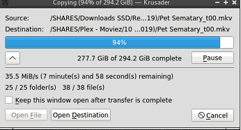

But if I now copy the data from the cache to the discs with Krusader, I get a maximum transfer rate of 20-40 mb/s.
MiB/s

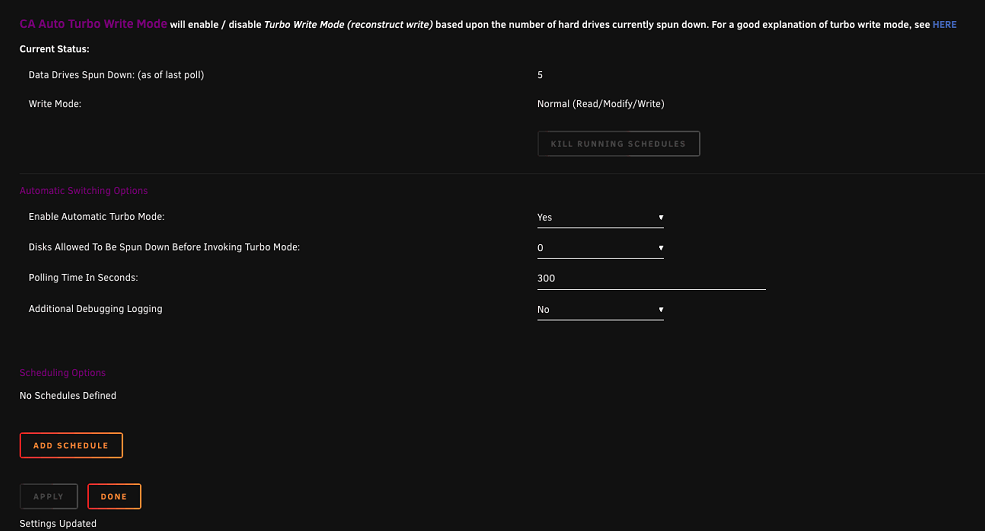

Yes, I did. It's installed. Do I have to change the settings?
That's pretty slow, especially if all drives are fast. Would it help if I would connect the HDDs to a PCI-E controller instead of motherboard? All 8 discs are connected to the Asus motherboard now.
I noticed that the first 3-5 seconds transfer rate is 500mb/s and then drops to a constant 25-50mb / s.
Thank you!
Thank you!
Your current Write Mode is "Normal" i.e. Turbo Write is off.
I would suggest doing your test without the plugin. The settings for Turbo Write is controlled natively in Unraid settings
You don't actually need the plugin to turn it on and for testing purposes, having the plugin introduces a variable i.e. it can turn off Turbo Write when you want it on etc.

  • The initial bust is due to write caching in RAM.
