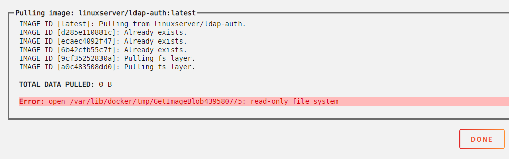

After a while the shares came up and eventually the dockers, but I get a error starting them:
Then I tried installing a ramdom docker:
The hell??

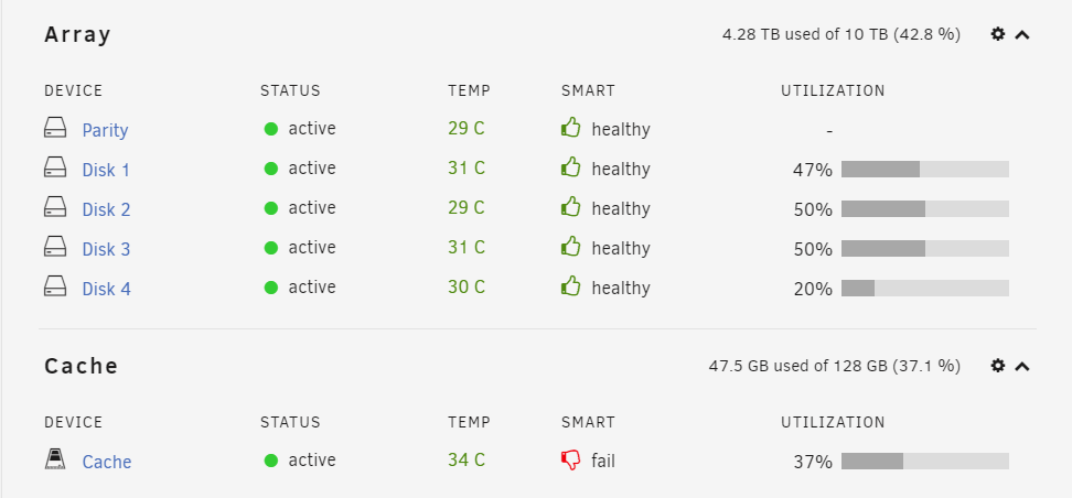

Then I checked my dashboard:

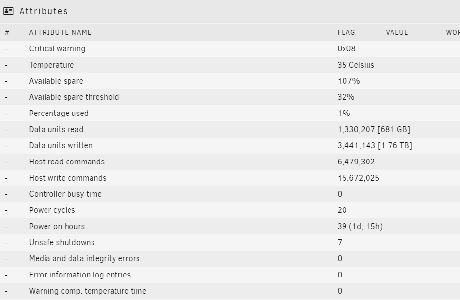

Active, but SMART failure
7 unsafe shutdowns (probably the offline online)

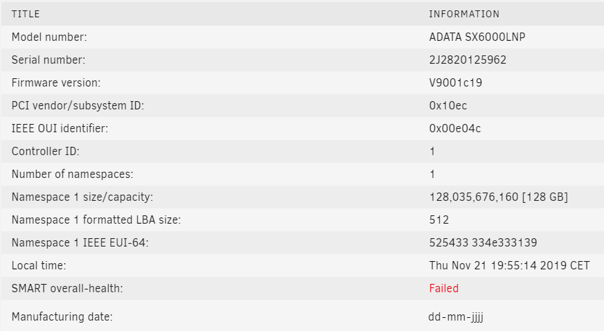

and extra information:
And also the diagnostics.sys

Cache filesystem or the docker image are likely corrupt, also SMART fail is a big red flag, you should replace it.
Missed the diags, yep, cache filesystem is corrupt, IMHO not much point in trying to fix, just replace the cache device.
It looks like a garbage ADATA drive, I wouldn’t be remotely surprised it has failed & agree with johnnie, time to feed it to the woodchipper 😛
