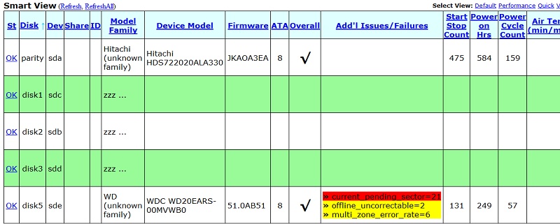

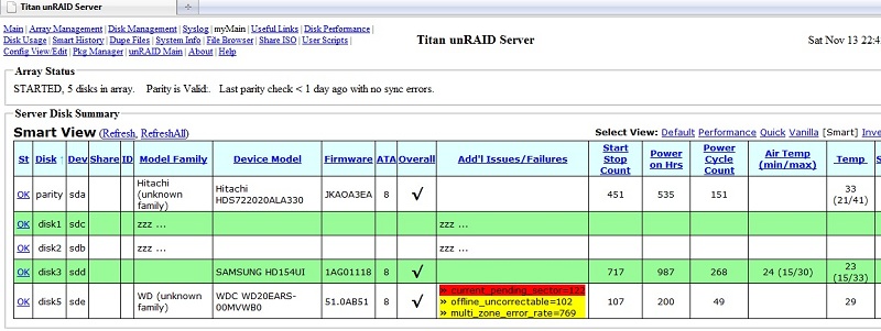

offline_uncorrectable / multi_zone_error_rate
Please see attached screen shots.
Screen shot 01 was taken last week.  Screen shot 02 was taken today.
I'm curious if I should RMA this WD20EARS drive or not.  Any advice would be appreciated!

i think the best way you can do is openning a case with tech support from Western Digital, send them your smart results and asking for comment. I will be worrying about disk sde, not because of those error counts (error counts for this disk at 20101120 doesn't look like abnormal) but the way error count rolling backward, might be signaling faulty PCB board?
