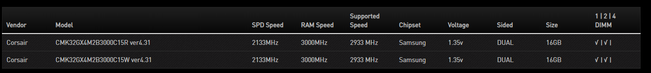

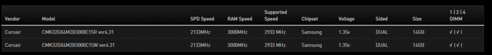

Should be noted ( *IF* I've got the model number of your RAM right ) that it is listed as being incompatible with your board in a 4 dimm configuration on MSI's QVL
(But there are other 3000MHz 16GB dimms that MSI does list as being compatible in 4 DIMM configs)
I didn't think a lack of checkmark necessarily meant incompatible, I thought a lack of checkmark means they simply hadn't tested it...i.e. they may have only had 2 DIMMs available for testing.   I agree it is probably worth going through MEMTEST and/or removing two and retrying as long as he's trying to get to the bottom of this.
