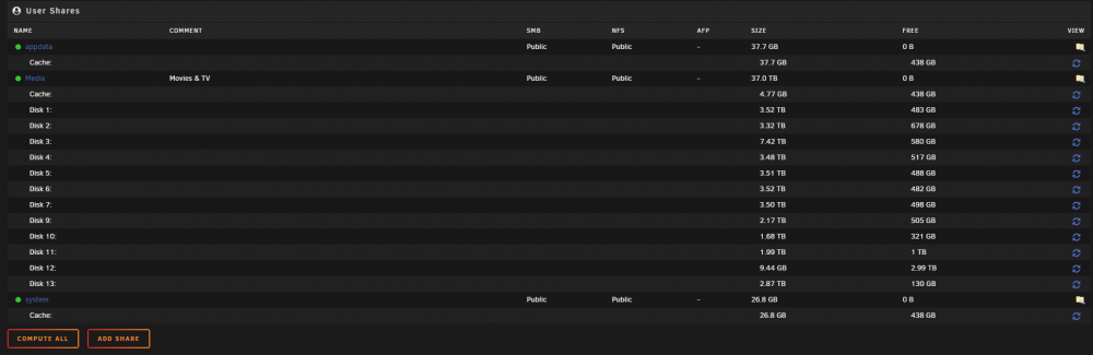

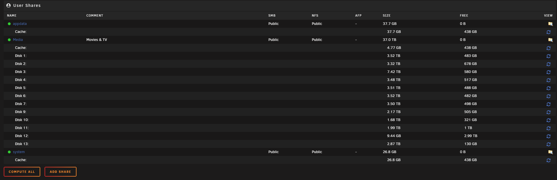

Next issue I've run into: I don't seem to have write access to my shares.  I'm not sure how this happened, I didn't change any settings in the shares.  I cannot write files from a Windows machine under SMB shares.  I also cannot write files on the Unraid machine itself using Krusader.
Any suggestions on how to proceed?  Again thank you guys.  I'd always felt reasonably good about my set up, but this week feel like such a failure at this.
Edit: FWIW I cannot add any additional shares now either.
