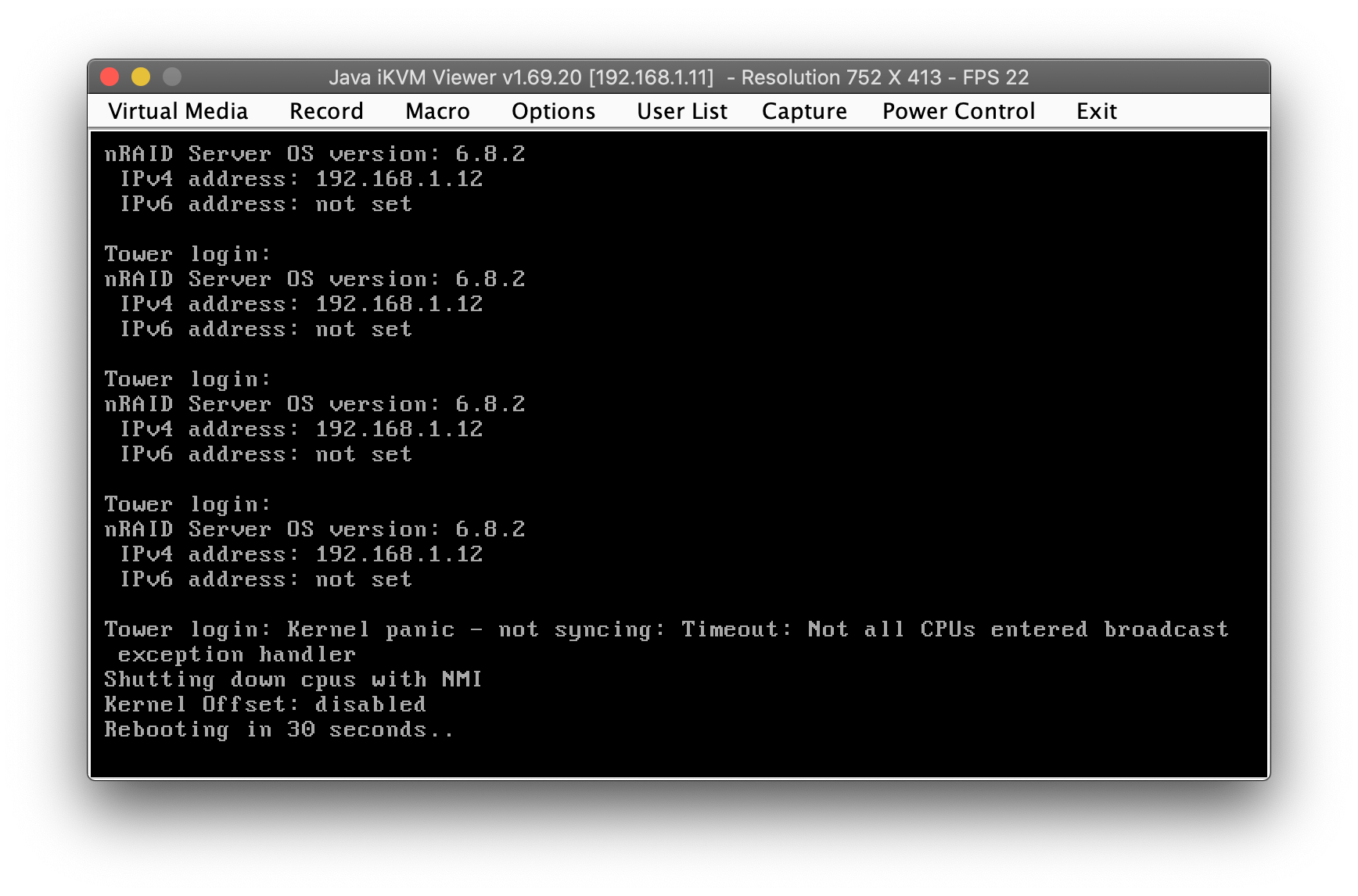

I am having the same issue with my x9dri-ln4f+ system as well (attached diagnostics when the system rebooted as well as the screenshot from the KVM view moments after starting the VM).
Here is the XML configuration for said VM:

tower-diagnostics-20200304-0627.zip
EDIT:
On reboot, the GPU was not accessible from the unraid UI, I removed the GPU and soundcard entry, and the VM started without issue.  Now to figure out what happened to my GPU, and why trying to pass it through unraid to have a kernel panic.
Edited by ogi
additional information about GPU
Following up on this, I ended up rebuilding my USB due to another error, and this issue has gone away.
