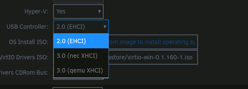

Ok, I think you have not the right controller: ehci is for usb 2.0, uhci is for usb 1.1. Try to change to XHCI controller.
its not letting me select the  xhci options
I'm sorry but I cannot help more. Certainly the problem of usb speed is related to usb 2.0 emulated controller.
The nec xhci should be compatible with windows 7, but I'm not 100% sure..
