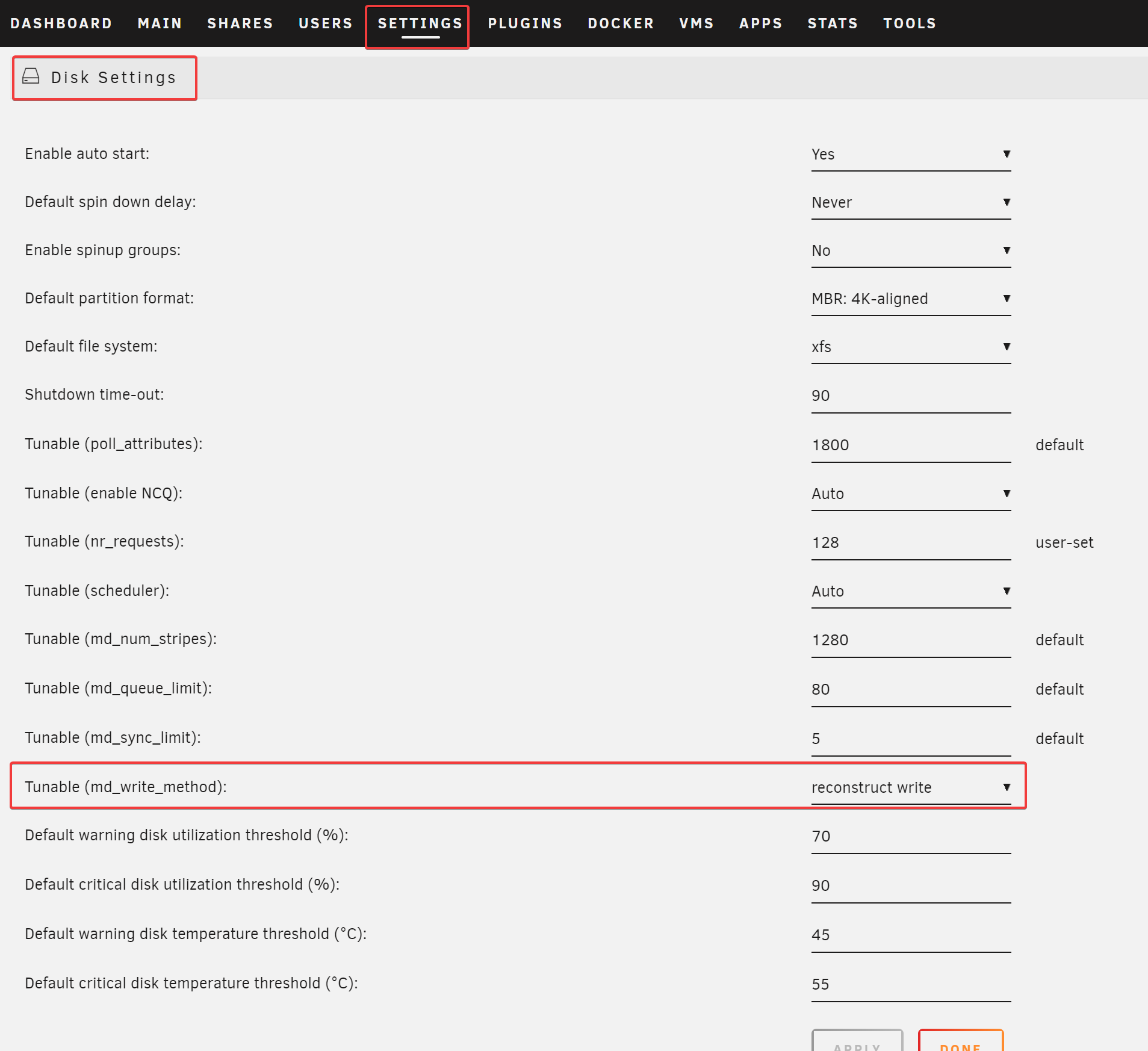

That reminds me of an important optimization he can make since he didn't say what those write speeds to the array were.
zwolfinger, you can improve your array write performance by changing the tunable to "reconstruct write":

On the md_write_method, can I make that change, copy my media over, and then change it back?  I was reading about it and don't want to cause stuttering in my video playback.
Can I change it without having to restart the array?  I'm currently in the middle of a parity check as well.

That Turbo write method they mentioned actually gets all of the disks involved with parity updates, instead of just the disk being written plus parity, so that is definitely a tradeoff and might not help much if you are trying to do too many things at once, another case of competing for the disks.
