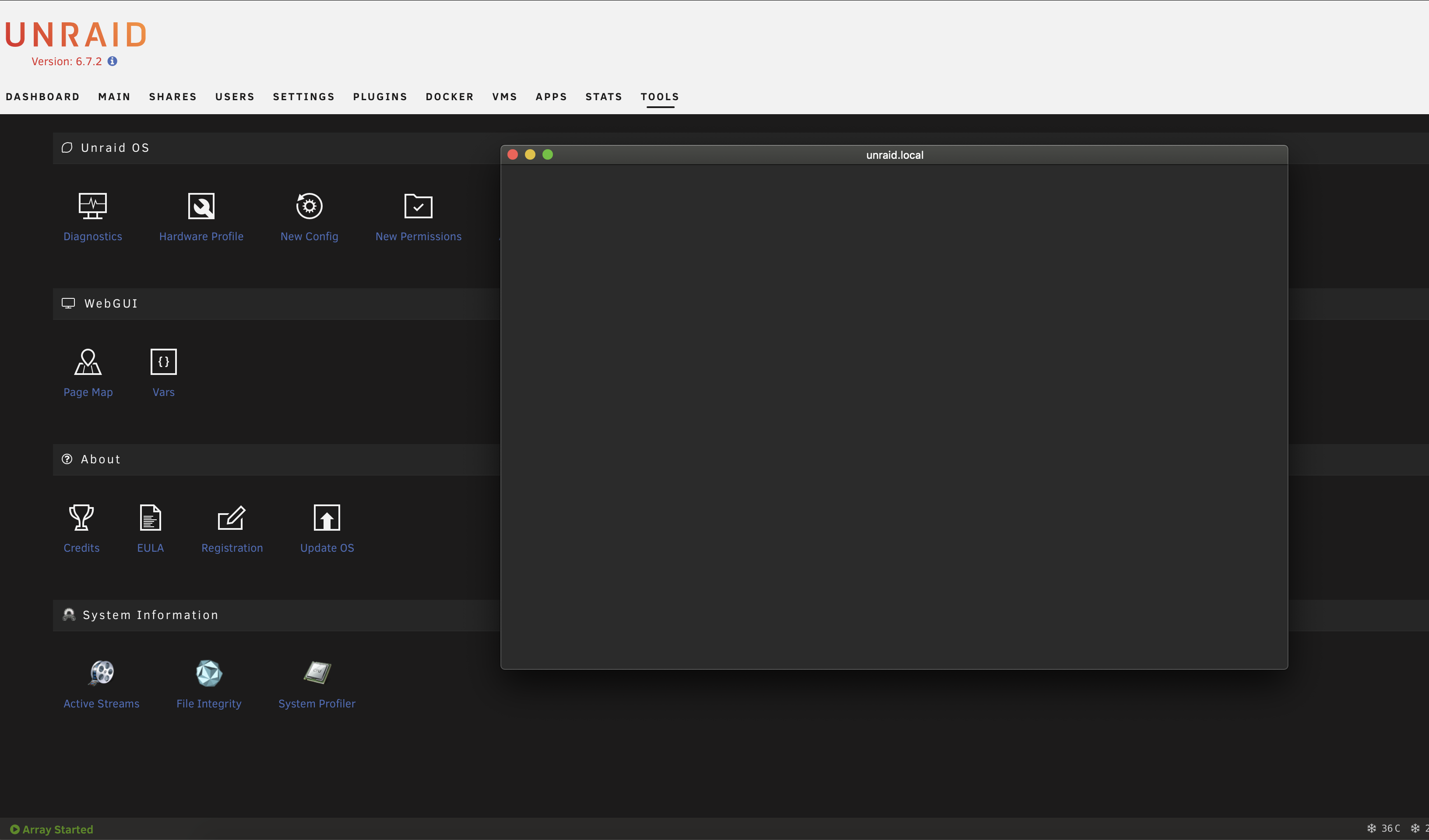

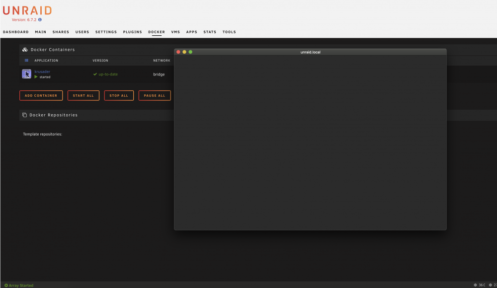

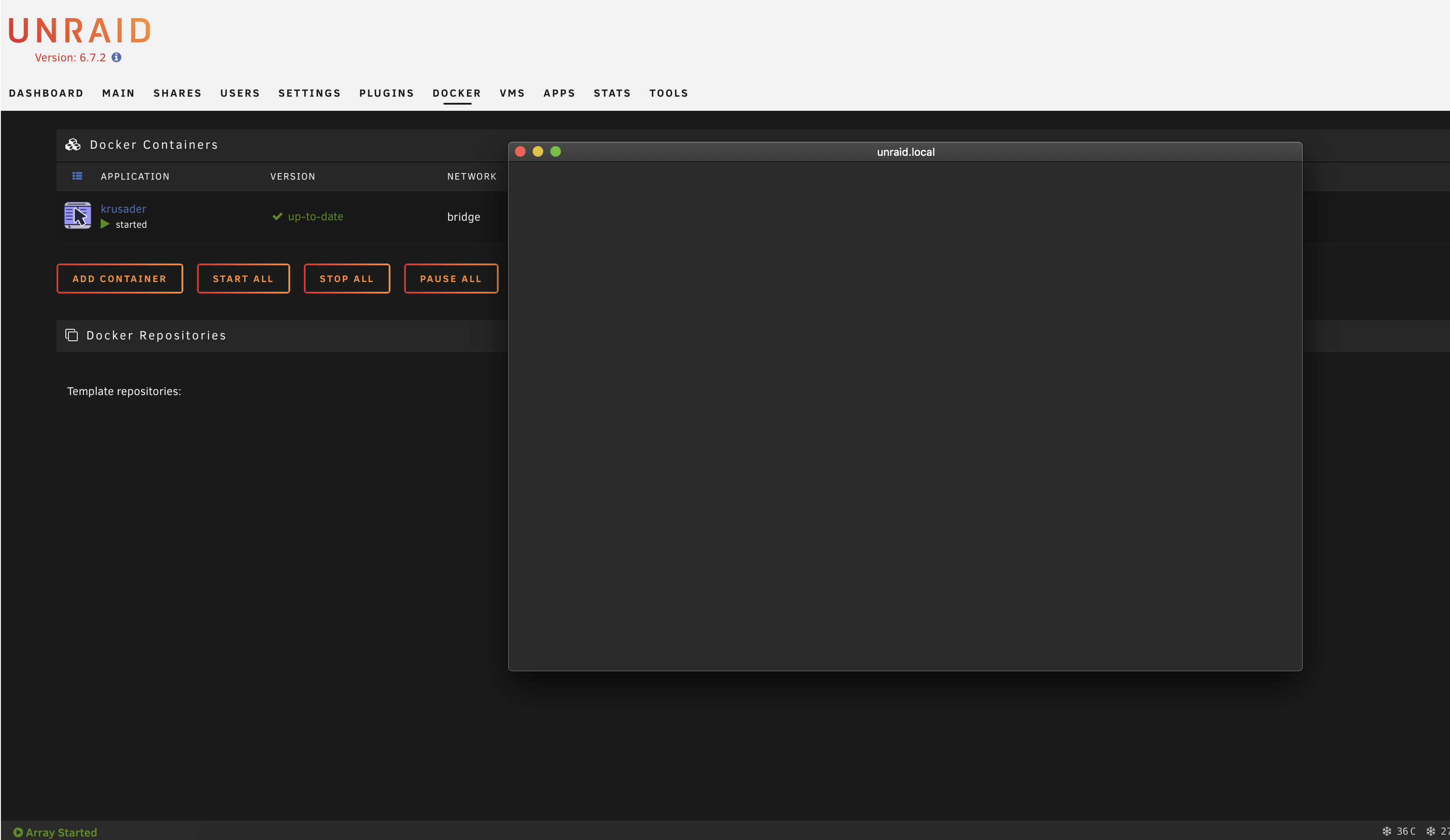

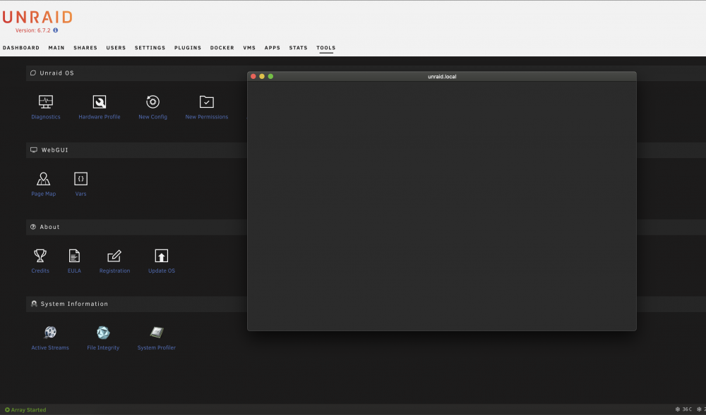

Finally, the terminal button at the top right of the main Unraid screen doesn't work, it just gives me a grey/blank pop up screen.  Likewise, if I choose the command line option from Krusader, again, I get a light grey blank screen.
Is this from the server GUI mode builtin browser or from another browser on a different computer? Which browser?

Thanks for the quick reply, I have attached the diagnostics.  Some of the folders are the same size exactly, to the byte, others not so, which seemed odd, you'd think they would all be out by a few hundred bytes?
Browser is Safari Version 13.0.3 (14608.3.10.10.1) on iMac running Mojave 10.14.6.   I have attached a couple of screenshots so you can see what I mean.
Can you try a different browser to see if you get a different result?
Works for Krusader and the console with Firefox 70.0.1.

Thanks to Truro for suggesting trying a different browser.  The Krusader blank screen problem seems to be related to Safari as it works with Firefox.  Hopefully the Safari side of things can be fixed for those of us that use Safari?

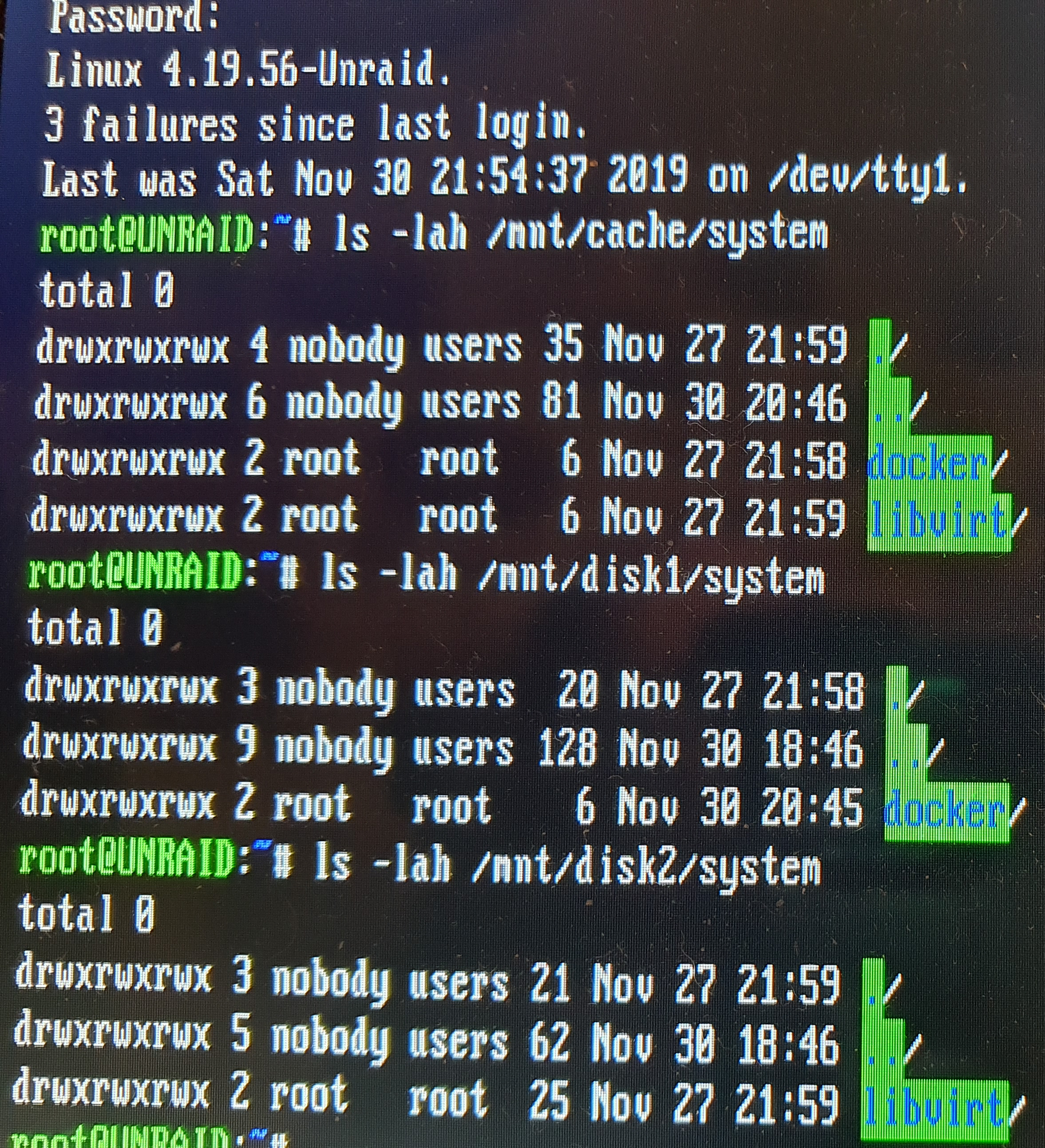

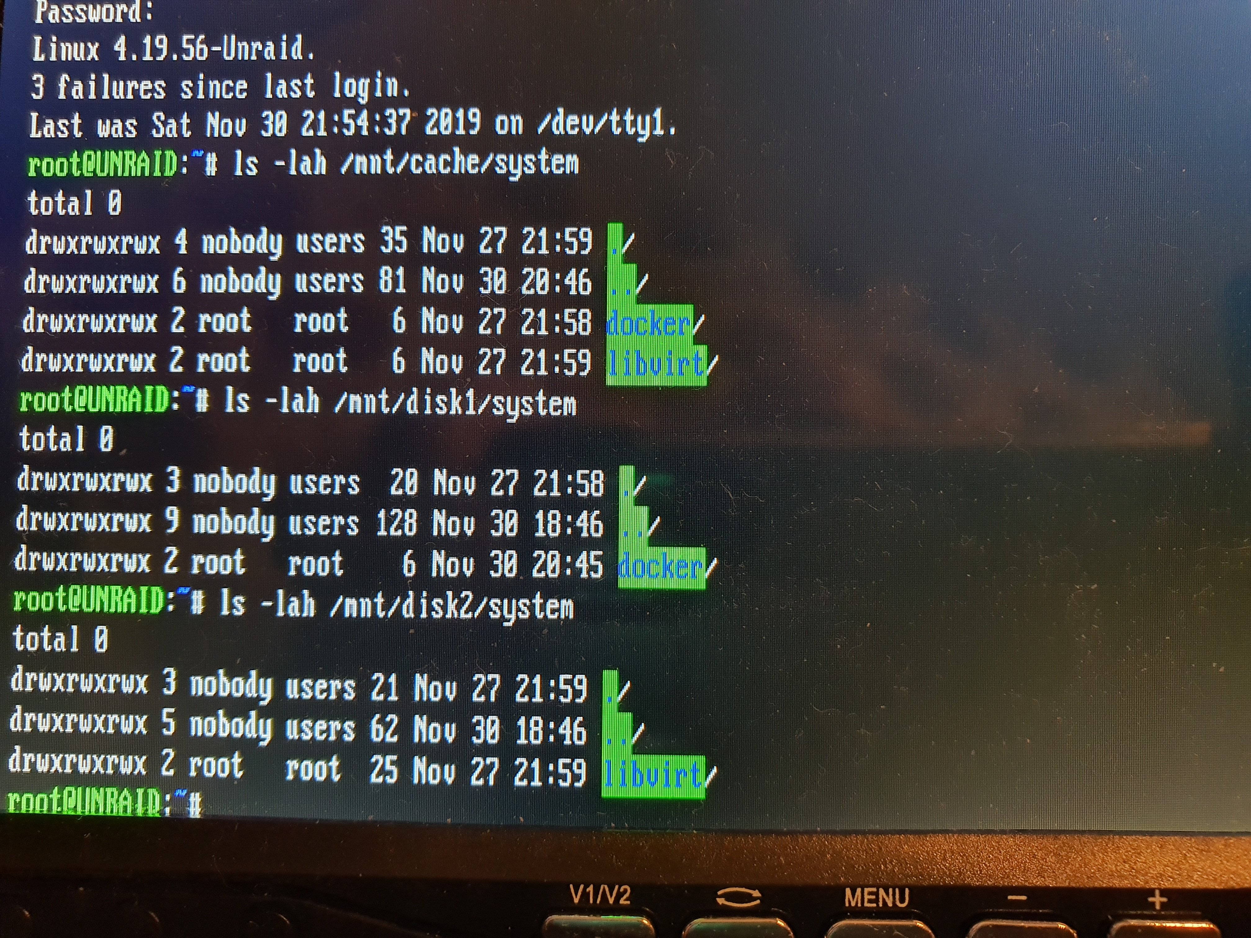

Your system share still has files on array disks 1 and 2.
What do you get from the command line with these?
ls -lah /mnt/cache/system
ls -lah /mnt/disk1/system
ls -lah /mnt/disk2/system

Have you done anything since you posted your last diagnostics? Is the array actually started?
That sh-5.0# doesn't seem right either. Are you actually at the command line of your Unraid server?
Thanks again.  The array is started and nope, I haven't done anything else, other than reinstalled crusader.  Do you mean the command line on the server itself rather than from in the webUI?  The above was from the web command line, I'll do it the other way, sorry, I'm learning!
The webUI command line should work the same. Something not right about your results though. From my server the prompt is
root@unserver:~#
where root is the user (the only user that can access the command line) and unserver is my server name.
I don't know how you could even get it to say
sh-5.0#
What do you get with this?

I just opened it and that was the prompt, I have just opened it again and it was root@unraid, so I'm not sure what that was.  Two screenshots of the other things you asked for.  Thanks.

Since you don't have any VMs yet, you can just disable VMs in VM Manager then delete those libvirt folders. You don't want them on the array and if you recreate them they should get recreated on cache anyway.
Same for Docker, disable and then delete those docker folders. Then you can recreate docker image and it should get created on cache where it belongs. Apps - Previous Apps will add your dockers just as they were.
Do you know how to work at the command line to delete those folders? I usually just use the builtin mc (Midnight Commander) when working with files and folders directly on the disks.
Then the system share should only exist on cache.
