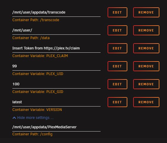

Did you map Plex appdata to /mnt/cache or /mnt/user?
/mnt/user/
I was under the impression if it was set to cache I wouldn't be able to access the content on the array on the stuff that hadn't been moved by the mover yet?

It is not normal for appdata to contain your media, but merely the Plex working files and as such keeping these on the cache is good for performance.   You will have a separate mapping to the plex container for the media and this SHOULD use /mnt/user.
ahh I think I'm getting my wires crossed sorry, my appdata is set to /mnt/user/appdata/PlexMediaServer so rather than user it should be cache?
In theory both should work if appdata is set to Use Cache = Prefer or Only.   However going directly to the drive by-passes the Fuse layer used to implement User Shares and is thus likely to perform better.

Interesting, ok just checked all my other containers, I'll switch them across to cache instead of user, and see if it makes a difference.
