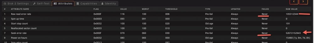

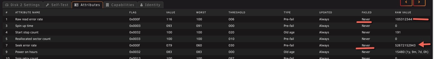

I may have found the problem due to my misinterpretation of the SMART attribute, although the drive shows green.
Main -> Drive 2 -> Attributes show Raw read error rate = 105312344 and Seek error rate = 52672152943
But, why does it say FAILED Never?
Is this the cause of the slow parity check?
Those are normal for Seagate drives, it's a multi bit attribute, server load seems very high, try again after rebooting in safe mode and leave all VM/dockers off, at least for a few minutes while you check the speed.
