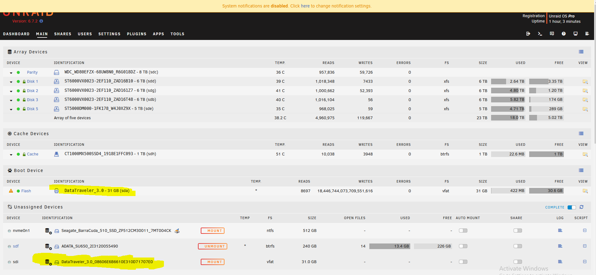

Unraid 1: Had to reboot to get this screen again, but this is how I have set my display.

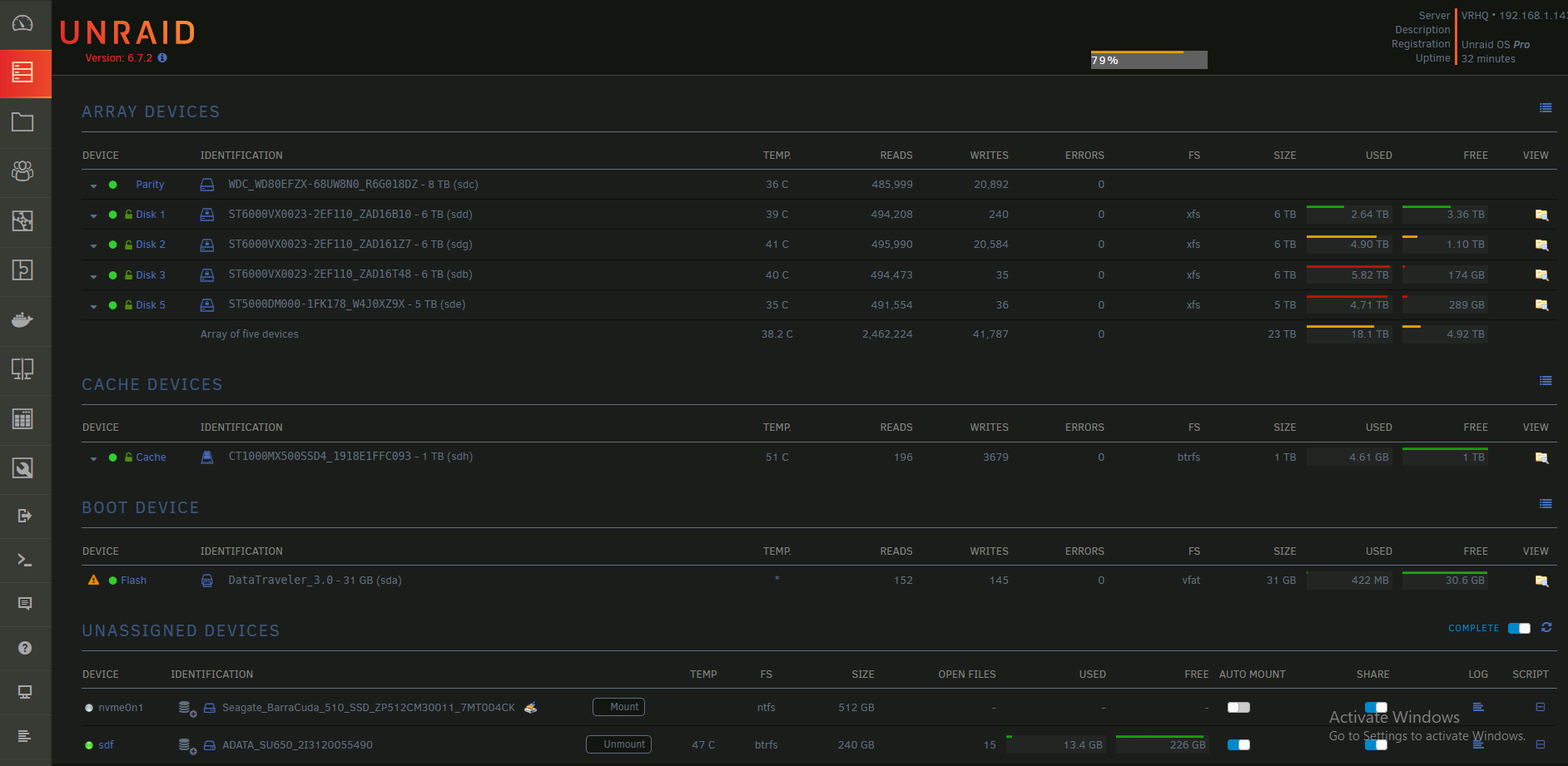

Unraid 2: This is how it look like after ... about 1 hours to 1 day. All docker and VM are running but their tabs are missing and even stopping the array and going to setting to add them again doesn't work. Can't strat new Docker thou and that is how I pick it up.

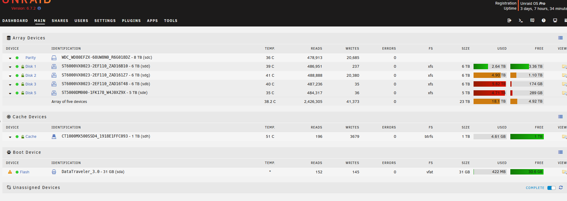

Unraid 3: Show after the restart that it reverted back, Also my USB where unraid is install on moved to unassigned devices (weird)

Sounds like your flash is disconnecting. It is best to use a USB2 port for the Unraid boot flash.

Try a different port for the flash.
