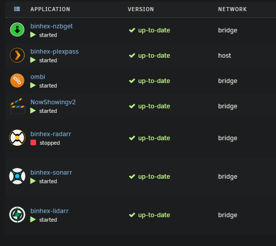

Im having issues with what i think to be permissions between 2 docker apps (NZBget, Sonarr).
Docker containers:
binhex-nzbget
  Settings:
           /data/mnt/cache/appdata/binhex-nzbget/data
           /config/mnt/cache/appdata/binhex-nzbget/config
binhex-sonarr (Version 2.0.0.5338, Mono Version 5.20.1)
  Settings:
           /config/mnt/cache/appdata/binhex-sonarr/config
           /data/mnt/cache/appdata/binhex-sonarr/data/
           /media/mnt/user/TV Shows/

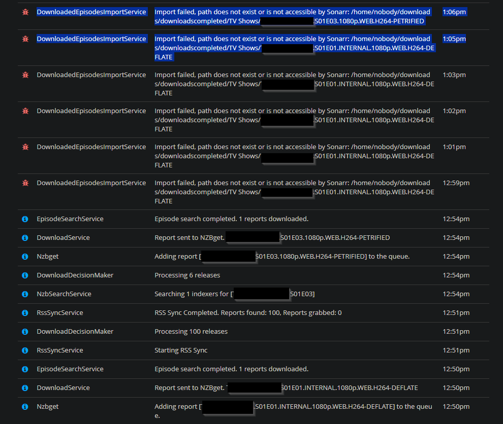

When i add a show it is able to connect to NZBget to search and download a file, the file will successfully download and NZBget states that it unpacks the file. However Sonarr never picks up the file. It appears that he file is able to be seen however i get the following error.
Import failed, path does not exist or is not accessible by Sonarr: /usr/local/bin/nzbget/downloads/completed/TV Shows/NAMEOFTVSHOW.S01E06.NAMEOFEPISODE.1080p..WEB-DL.DDP5.1.H.264-NTb

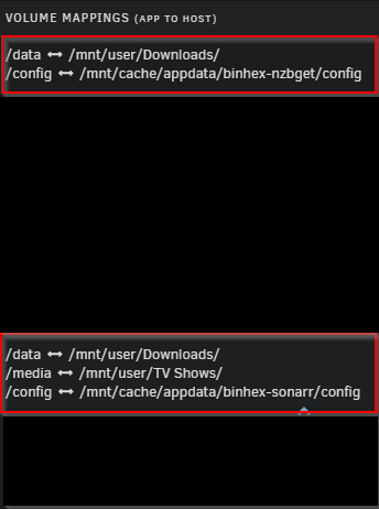

Thanks all for the reply, ok so i understand that i need to have a common path for the 2 apps. I have tried mapping sonarr to the download location and i get the same thing it will see the files and can initiate a download however it does not move the files or rename files etc. I have even created a separate share to test on one of the disks in the array instead of the cache drive. I have also tried restoring permissions via the script above.
As of now the config for both apps are as follows:
NZBget:
/data/mnt/user/Downloads/
Sonarr:
UMASK is set to 1000

Also to clarify since you didn't have any spaces between variable name and value, these are your path settings? (I had to assume the topmost level was the variable name and anything after level 2 was the value)
NZBget:
/data = /mnt/user/Downloads/
/config = /mnt/cache/appdata/binhex-nzbget/config
Sonarr:
/media = /mnt/user/TV Shows/
/config = /mnt/cache/appdata/binhex-sonarr/config
For reference my nzbget uses the following (may be slightly different than others as I had a working config going back years and didn't want to change it), but your /data is equivalent to my /downloads :
/downloads = /mnt/cache/downloads
/config = /mnt/cache/appdata/nzbget
That is correct it should be:
NZBget:
Sonarr:

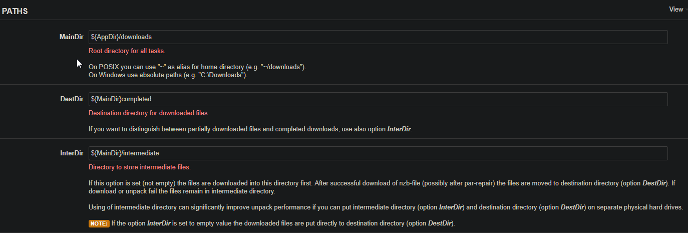

And for the paths in the NZBget when it says ${AppDir} that should refer the the \Data Location = /mnt/user/Downloads/
So in that location you should see /mnt/user/Downloads/downloads/completed
and /mnt/user/Downloads/downloads/intermediate
${MainDir} should refer to the previous location of  /mnt/user/Downloads/downloads

If that doesn't work, set MainDir to be "/data" or "/data/downloads" inside of nzbget config, depending on how you want it structured. That way there's no questions as to what ${AppDir} actually is.

Ok, just tried downloading with UMASK set to 000 and
NZBget:
Sonarr:
with path set in ZNBget to ${MainDir}/downloads, that did not resolve the issue. I will now try with /Data set for the MainDir.
Testing with MainDir set to \Data appears to give this error:
ERRORThu Nov 28 2019 12:43:09Could not create file /Data/tmp/nzb-20.tmp
Now testing with \Data\downloads
Testing with MainDir set to \Data\downloads appears to give same error:
ERRORThu Nov 28 2019 12:47:09Could not create file /Data/downloads/tmp/nzb-38.tmp
Setting MainDir back to ${MainDir}/downloads appears to allow downloading of files:
INFOThu Nov 28 2019 12:51:30Successfully downloaded NAMEOFTVSHOW.S01E01.INTERNAL.1080p.WEB.H264-DEFLATE/dTPKvBPUY1j5F9.part02.rar
Letting file finish with UMASK set to 000 to see if file will now import.
Confirmed that changing the MainDir back to ${MainDir}/downloads allows for the downloading of files however UMASK set to 000 does not appear to solve the issue with files being moved over.

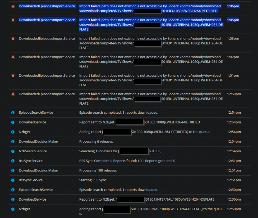

Sonarr Log:
DownloadedEpisodesImportServiceImport failed, path does not exist or is not accessible by Sonarr: /home/nobody/downloads/downloadscompleted/TV Shows/NAMEOFTVSHOW.S01E03.1080p.WEB.H264-PETRIFIED1:06pm
EpisodeSearchServiceEpisode search completed. 1 reports downloaded.12:54pm
DownloadServiceReport sent to NZBget. NAMEOFTVSHOW.S01E03.1080p.WEB.H264-PETRIFIED12:54pm
NzbgetAdding report [NAMEOFTVSHOW.S01E03.1080p.WEB.H264-PETRIFIED] to the queue.12:54pm
DownloadDecisionMakerProcessing 6 releases12:54pm
NzbSearchServiceSearching 1 indexers for [NAME OF TV SHOW: S01E03]12:54pm
RssSyncServiceRSS Sync Completed. Reports found: 100, Reports grabbed: 012:51pm
DownloadDecisionMakerProcessing 100 releases12:51pm
RssSyncServiceStarting RSS Sync12:51pm
EpisodeSearchServiceEpisode search completed. 1 reports downloaded.12:50pm
It appears that changing the UMASK had no effect or the wrong setting was used?
Edited by IrishFavor
This means that the main dir was still set to {$AppDir}.  Main dir should be /data
4 hours ago, IrishFavor said:
NZBget:
Sonarr:
/data is NOT the same as /Data
The paths must match.

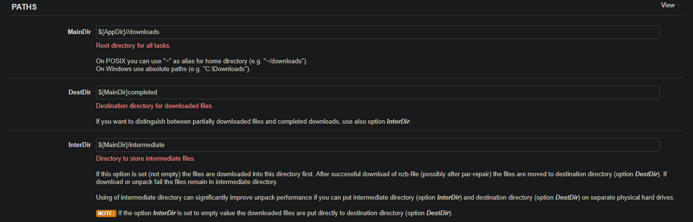

Very subtle, but you've got DestDir as
${MainDir}completed
where is should be
${MainDir}/completed
The way you've got it, its moving completed files into the docker.img, and will explain everything else (maybe)
To fix this up, you're best off stopping the docker service (Settings), deleting the docker.img file, then re-adding the apps via Apps - Previous Apps
Aw crap i must have hit delete by accident while testing thanks for that catch, i don't think that was the issue i will update it and test. if that doesn't work as i have been changing settings perhaps a refresh from default is needed. I'll delete the apps and docker.img and try again.
