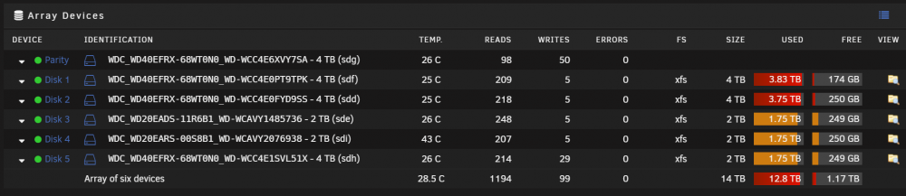

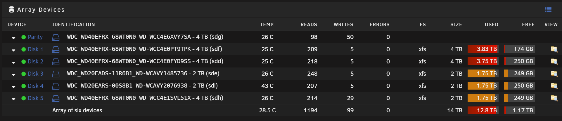

On closer inspection I noticed that the array capacity was still at 14TB. In the main window in Unraid the disk details for disk 5 showed:
·      Green light for the disk on the far left
·      The correct serial number and capacity of the new disk on the left side
·      The capacity and utilisation numbers from the old disk on the right-hand side

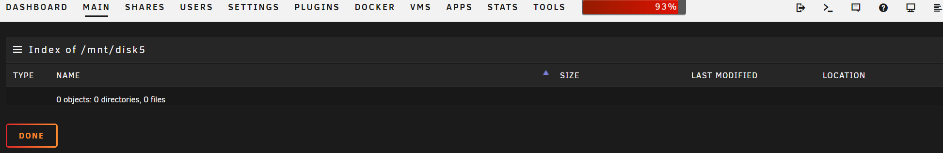

When accessing the disk directly using the folder icon on the right-hand side, Unraid tells me the disk has no files or folders.

If the disk was formatted the available capacity should be reported as 4 TB with 4 TB free.  Now Unraid tells me that the 4 TB disk is 2 TB and 1.75 TB is used.
When viewing the content of the disk from the Unraid GUI (folder icon on the right-hand side) there are no files.
