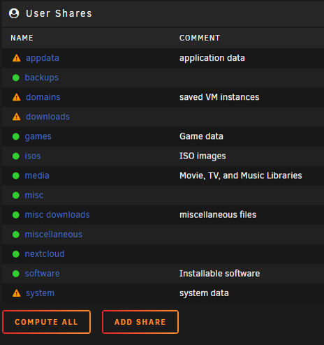

I mean I don't think so, here's a screen of my shares. Could you elaborate?
Check your flash drive (config/shares), names are partially anonimized, but there is a m----a share, and another called M---a.
Hmm, you're right. in /boot/config/shares there is a Media.cfg (but not a media.cfg) while in user shares, as in my screen shot, the share is named "media".
I would note that I haven't edited any of my shares main shares in over a year and this problem only started very recently.
Check all your disks, if media and Media exists on any of them, as a top folder.

According to your diagnostics, your media(1).cfg has settings. This is likely the Media.cfg file you are seeing. But there is no share by that name (no files). The media share itself has default settings, and that is the share that has the files. You might try deleting Media.cfg, reboot and make settings for the media share to see if that clears up the confusion.

I am not seeing "media(1).cfg" anywhere. Diagnostics file has a M---a.cfg and m---a.cfg file, but my only share in /mnt/user is "media" and in /boot/config/shares I only have Media.cfg (which must correspond to my actual media share).  I am hesitant to delete the .cfg as the majority of my files are in that share.
