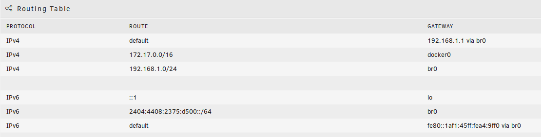

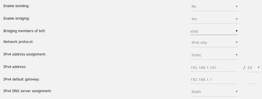

As the title says, I can access the internet via ipv6 even though I have set ipv4 to only. I am not skilled by any means when it comes to networking, but surely ipv6 should be disabled?

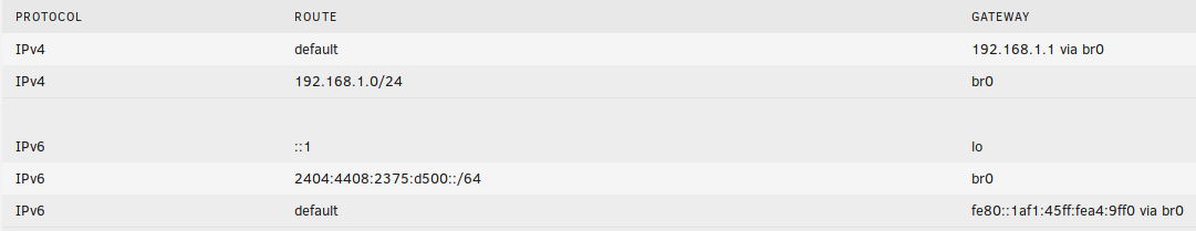

If I manually remove the ipv6 routes through the GUI, ipv6 is disabled for a minute or two before the routes re-populate. If someone could help me figure out why IPv6 is enabled, that would be great. Looks like I might need to just use ipv6.disable=1 as a kernel parameter
