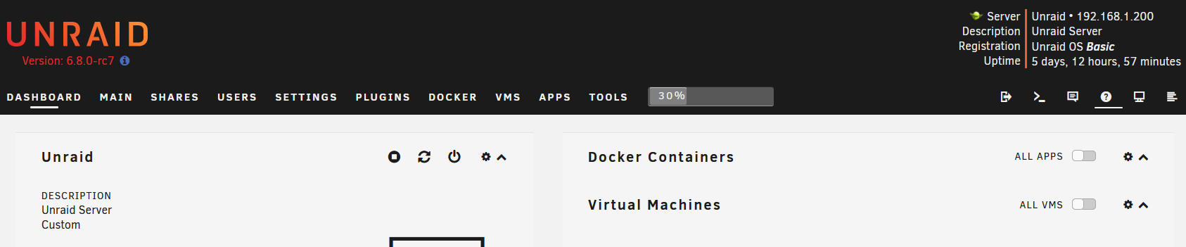

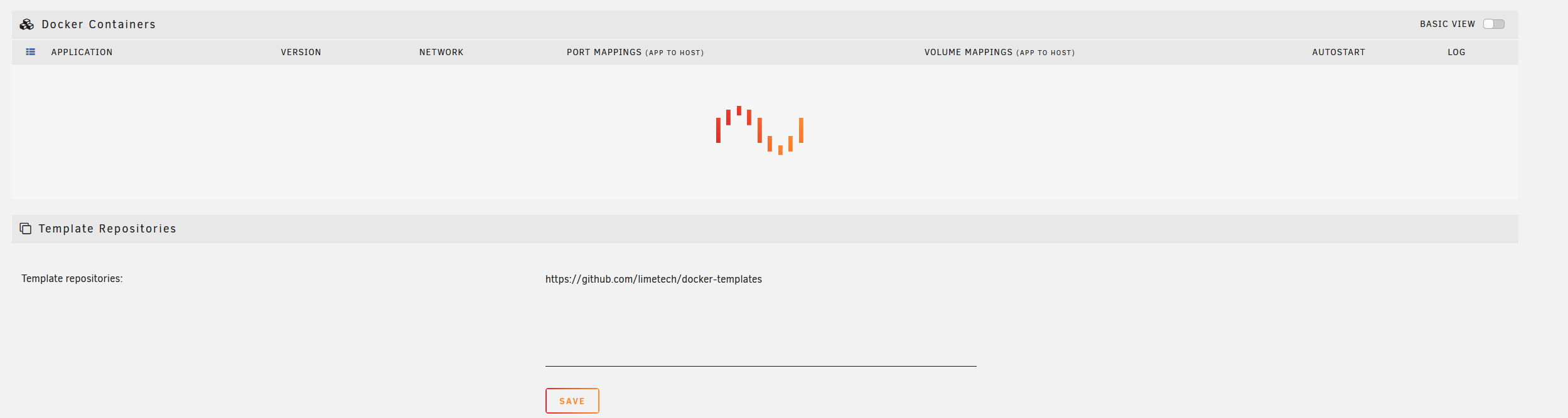

When I open the docker or apps tab it take like a minute or two to show the contents
Anyone can help my to troubleshot this? I have tried everything related with DNS settings already.
In the dashboard tab I dont see dockers or VM after a while of openning the page. VM tab loads quickly and without any issue

Fixed, it was a "Icon URL" link that was broken in one of the dockers. I have been breaking my head the last weeks with this problem, I tried everything and at the end... xD
Maybe you could add something in fix common problems to detect this.

a custom container I made for minemeld docker where I used an external link to show the icon.
