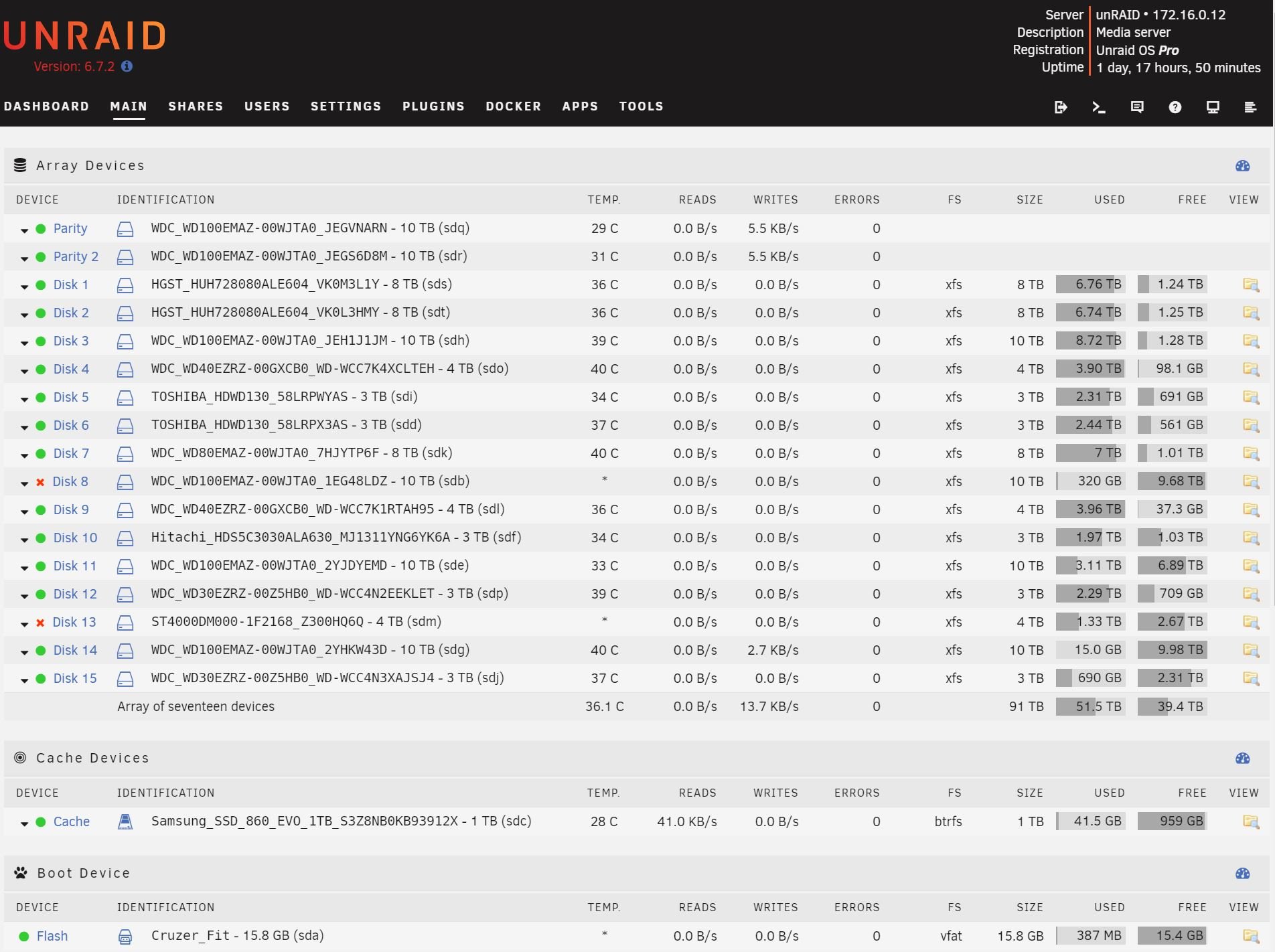

I had 3 drives drop out of the array per the thread below.  I have 2 parity drives so I was able to rebuild two from parity and the third had data loss.
What  I did:
  • I had a new precleared WD 10tb that I put in as Disk 8 (WD10...48LDZ).
  • I then precleared the replaced former Disk 8 (WD10...W43D) as Disk 14, that's running fine now.
  • Disk 11 was ultimately reformatted and returned to the array after some checks per the other thread.
Disks 8 and 14 rebuilding about a week ago and the array all good for about 24 hours.  Then a regularly scheduled parity check started Wednesday morning.  I came home to an unresponsive server.  I rebooted and now Disks 8 and 13 are fubared.  Disk 13 had not previously had an issue.  I turned the server off for the last couple of days as I was out of town for the holiday.
I can obviously rebuild from array but the reliability is majorly in questions.
Any ideas on troubleshooting this?
I do have another motherboard, CPU, and PSU I could try if it is recommended.  I'm running a pair of Supermicro AOC-SASLP-MV8 that I've used a couple of years and had no issues with previously.  I replaced the breakout cables per the previous thread.  All running in an early-gen Norco RPC-2040 4U case.

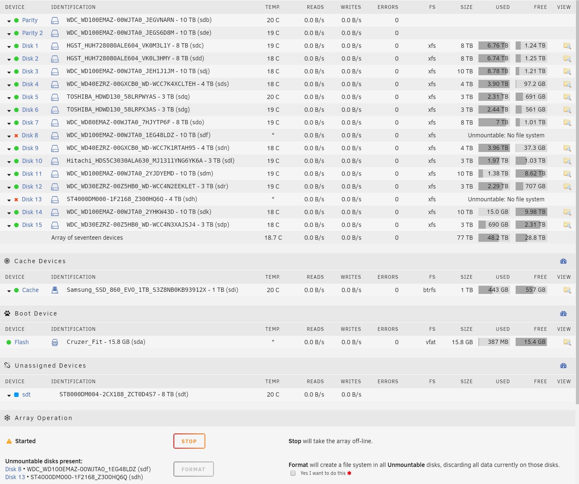

And current diags please, grabbed after array start.
I would expect disk8 to now mount fine as that is the result to expect of xfs_repair completes without error.
It appears disk13 cannot be accessed.   This suggests it is either offline or has really failed.    Posting the current diagnostics might give a clue.
That's just the syslog, tools -> diagnostics
There's a problem with parity2, and since 2 disks are disabled both can't be emulated correctly:

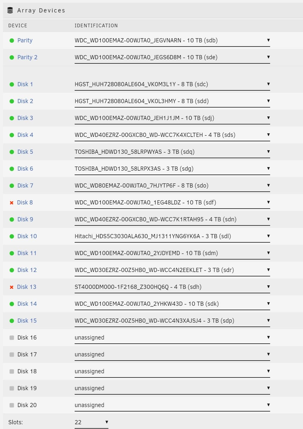

Been sick this week, just getting back to this.  I bought new SATA cables for all 4 drives running off the mobo including the 2 parity drives.  I started the array in Maintenance mode, ran xfs_repair with no modifiers.  It said to start the array and then rerun, use -L if that didn't work.
Here is the diagnostics file while the array is back up.  I have not gone back in to Maintenance mode yet and reran anything.

I started the array and the disk now show up with Used and Free space (instead of Unmountable) but are still emulated.
That's expected since once a disk is disabled it needs to be rebuilt, you can rebuild on top of the old disks, but before doing that make sure the data on the emulated disks looks correct, and there are no lost+found folder with data.
