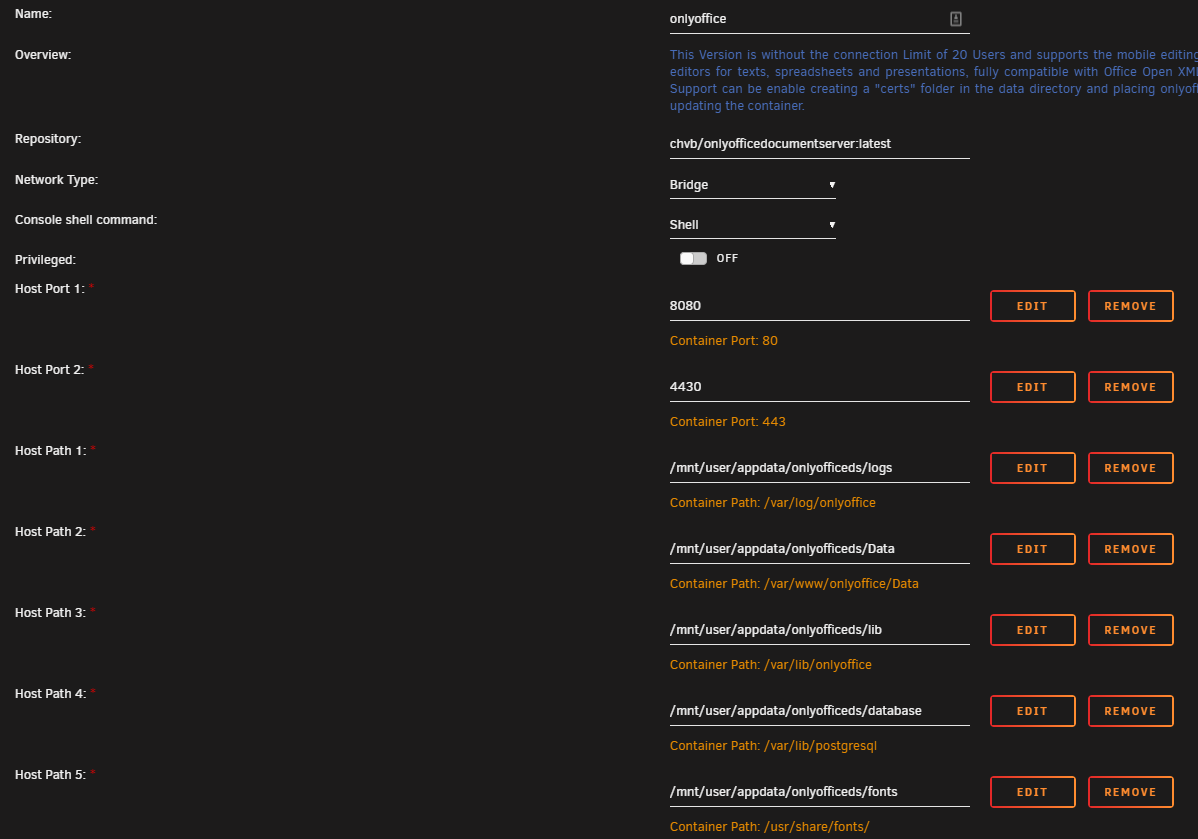

I am hoping you guys can shed some light on this issue I am having. I've have not been able to get this container to work. I am not sure if I am missing something here. This is a fresh new install of UnRaid and I just installed Nextcloud and have that working with SWAG. I wanted to integrate OnlyOffice as I had this working before on my old server. I have not touched anything on the Nextcloud side of things. I just installed your version of OnlyOffice Document Server and I have not modified anything. Its just a vanilla install of the docker, I wanted to make sure it works before moving on but I don't get any kind of webui.
All I get is the following page I've also attached the log file. I don't see anything out of the ordinary.
Here is the docker setup the only thing I changed was the container name to 'onlyoffice' just because that is what my subdomain is 'onlyoffice.mydomain.com'

    You need to configure document server to use ssl by creating the certificates and then add them in the folder: /mnt/user/appdata/onlyoffice/DocumentServer/data/certs/ After you add them you

  • FYI for anyone having issues I was able to get this working by using an older version of OnlyOfficeDocumentServer as described here on this reddit post! I now have OnlyOffice working with my NextCloud
FYI for anyone having issues I was able to get this working by using an older version of OnlyOfficeDocumentServer as described here on this reddit post! I now have OnlyOffice working with my NextCloud again.
