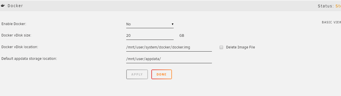

Go to Settings - Docker, disable and delete the docker image. Do the same for Settings - VM Manager. Leave them disabled and deleted until you get a lot of other things fixed.
 Go to Settings - VM Manager, disable and delete the libvirt image.

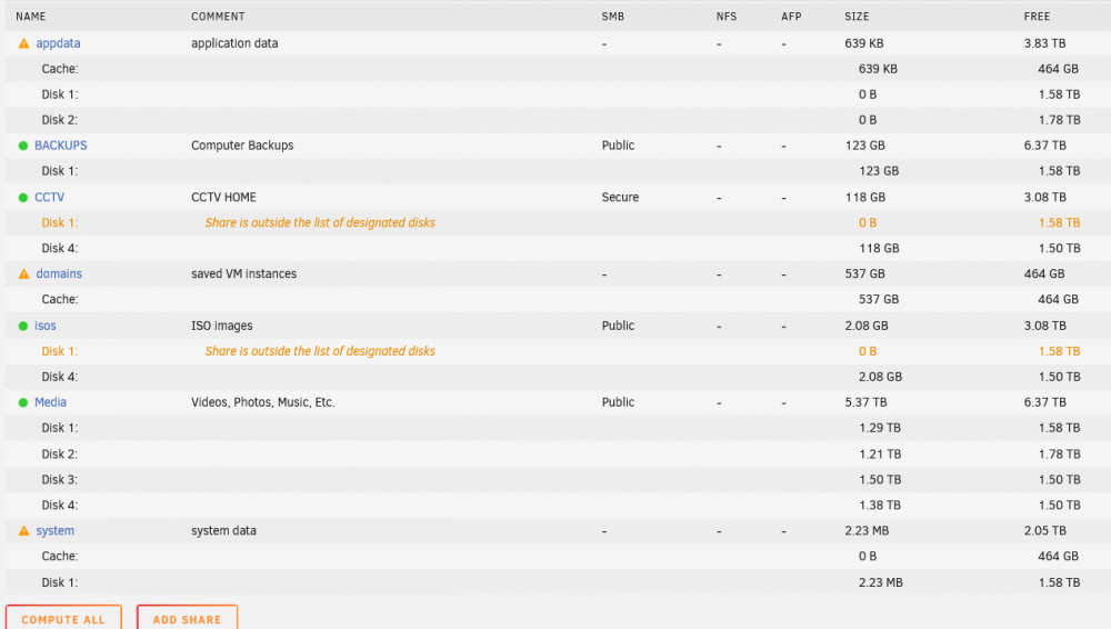

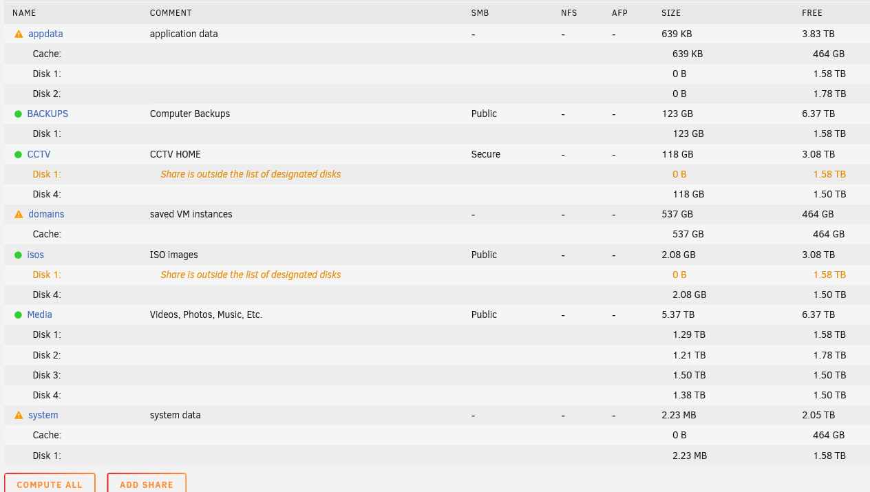

Go to Shares - User Shares, click Compute All, wait for the results. If you don't get a result after several minutes, refresh the screen.
Then post a screenshot of those results and a new Diagnostic.

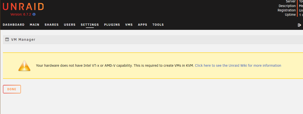

I am not able to disable my VM Manager, see image below
As for the Share  info, here is my screenshot...   FYI I am moving my CCTV to external share when I get this thing back up and running.
Wonder how you ever got it enabled in the first place. You should be able to disable it by editing the file on flash at config/domain.cfg then restart the array. There are several ways you could edit that file but the simplest to explain would be to shutdown, put flash in your PC and edit it there. Then we should be able to get rid of that last bit of system share on disk1.
Why do you have anything at all in the domains share?
Doesn't look like you have much in appdata to save so maybe the simplest thing to do would be to just delete it.
