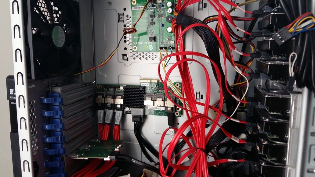

Either way will work, without the expander don't forget you're limited to SATA cables max length, 1m total from the HBA to the disks, you can use the expander on the 2nd case and connect that to the HBA, then the HBA -> Expander link can be much longer (10m max), expander to disks is the same 1m, but since the expander is in the case it won't be a problem, I use a similar setup for my two widest servers:
Bandwidth wise you'll have around 2200MB/s with single link and around 3000MB/s usable with dual link for all disks after the expander, which is enough for a reasonable number of disks.

HBA bandwidth is around the same 3000MB/s, limited by the PCIe slot, assuming it's on a x8 PCIe 2.0 slot.
You can power up the power supply with a clip, that's what I use on the other server.
