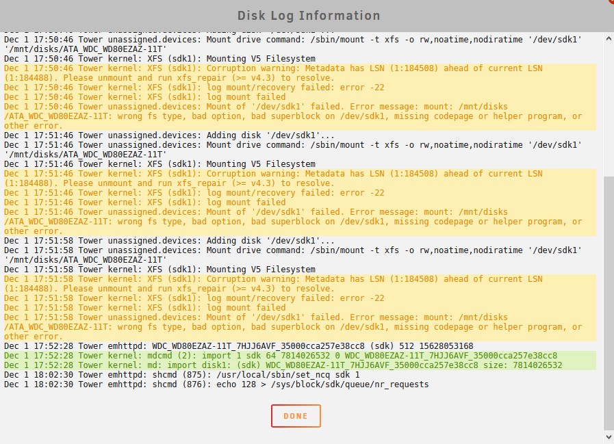

Edit: I checked the disc log. Forgot that was a thing you could click on, still getting used to this OS, see image:

Rerun the xfs_repair without the -n (no-modify) flag and the drive should mount fine once it has finished.
regarding you original issue if the drive had shown with the same serial number when being moved from the USB enclosure to the internal connection Unraid would have just picked it up fine.    However it appears that the drive was reported differently when in the USB enclosure compared to when it was directly attached which is why Unraid did not realise it was the same drive.
Thank you for your response! Yes it was listed as WD_My_ Book .....  . For future reference is it possible to ''explain'', to Unraid that it is the same device?
I did run the xfs_repair and it does mount.

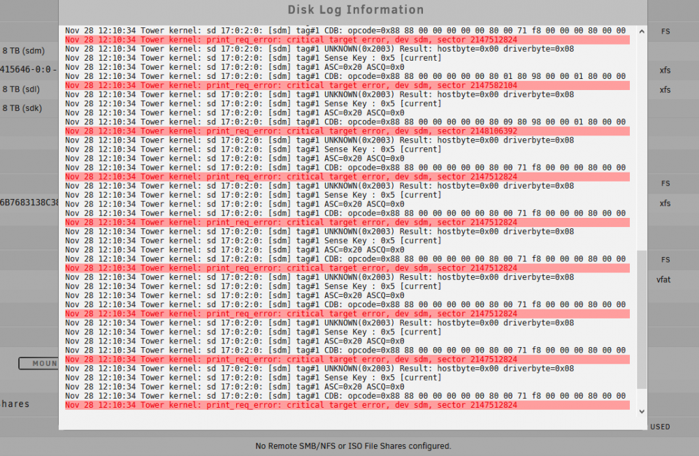

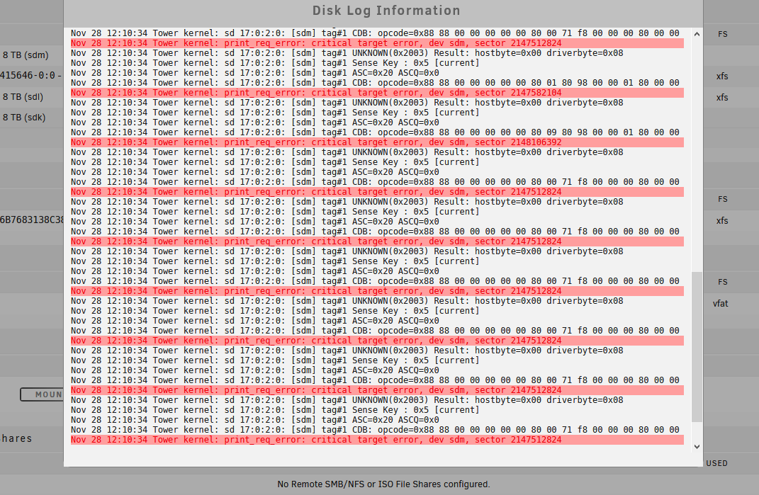

Still a little skeptical about trusting this system with my data i previously had 8.900.000  errors on the parity drive all confined to a certain moment in time.
