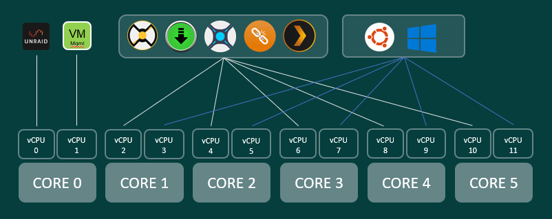

Maybe this Pinned CPU strategy could be optimized, what do you think?

Nice diagram but you might want to number the vCPU instead of the (physical) core since that's how Unraid will pin cores. So let's say you number the vCPU in the same way (so vCPU 0 + 1 = CORE 0) then
  • vCPU 0 should be left unpinned and unused for Unraid tasks. I think the more recent versions have gone multi-tasking so it's not as critical but it's always a good idea to leave something reserved for Unraid so everything doesn't grind to a halt.
  • vCPU 1, where possible, should also be left unused but you can use it for the VM emulator (since it doesn't use much processing power anyway).
  • Plex can share cores with all other dockers. You can set the Plex docker parameter such that Plex will have a higher priority and thus gets more CPU power when it needs to (instead of having Plex-only cores).
  • A trick that I use to maximize available cores is to only pin half a physical core for VM. So in your example, it would be something like this (number is by vCPU)
    • 0 - reserve for Unraid
    • 1 - VM emulator
    • 2,4,6,8,10 - dockers
    • 3,5,7,9,11 - VM pin
  • Intel / AMD multi-threading algorithm is surprisingly good. By using half a physical core that way:
    • When you are not running VM then your Plex has access to 5 physical cores to transcode.
    • When Plex is not transcoding then your VM has access to 5 physical cores for better performance.
    • When both run simultaneously, in my experience, I can tell there's a bit of latency but it's definitely not annoying.

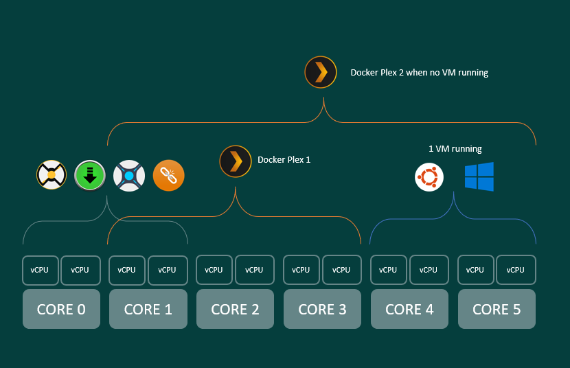

Schema updated according to your recommendation
