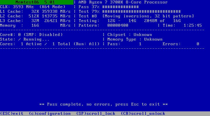

Currently letting  memtest86 run.
So far no errors, but i will probably  just let it run over night.

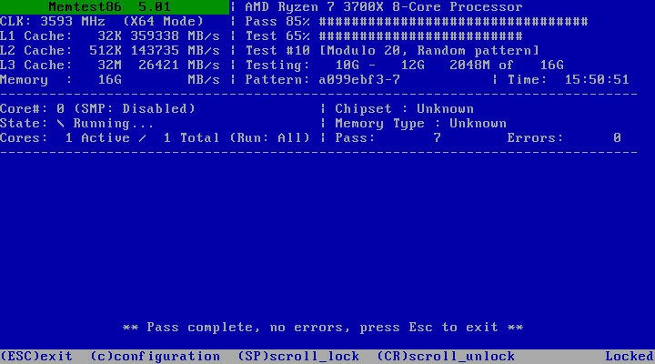

Oke, so i ran memtest86 for almost 16 hours on my single stick of 16 GB ECC unregistered ram. And after almost 16 hours not even a single error.
In the same period had the system been doing party, it would have had hundreds of thousands of errors if not millions.
Can ram now be ruled out ?
