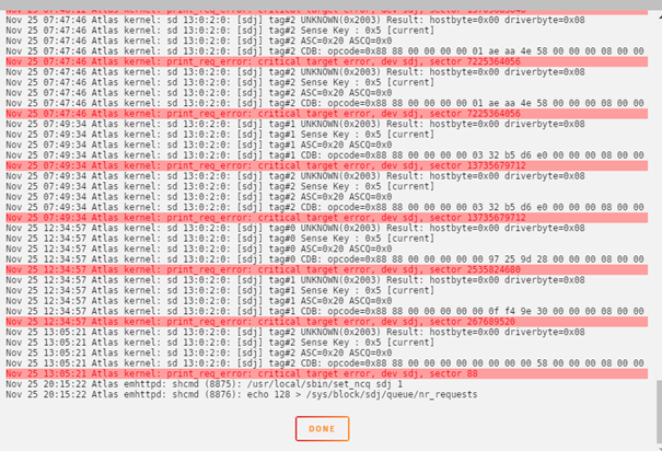

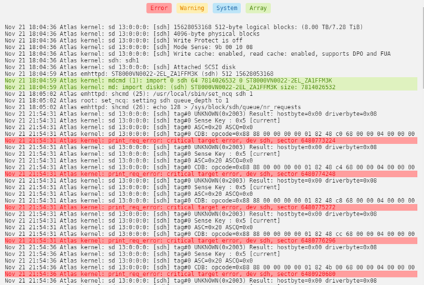

I have some weird disk errors that occur when I for instance start to copy files with the windows explorer onto a network share or otherwise use the system. It is not exactly logical to me what triggers the error. They happen usually on multiple disks at the exact same time and it does not seem to affect the system to hard but usually resulting in a copy error. After a restart they are obviously deleted but reoccur again.
image.png.171eea7f9f8a196ff725883541bd9138.png    image.png.f76baf45860d18c76c57602bafa848b3.png

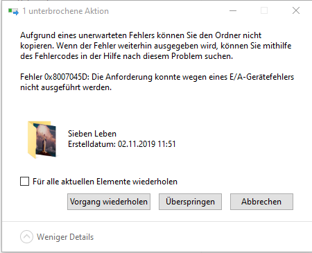

I am also not sure whether it is is connected to reaching a high water level mark. In those cases I get the following windows copy error:
Do you know how to avoid this kind of error? Each time a high water level is reached I have to at least once stop and restart the array to be able to start the copying process again. Shouldn't it normally switch automatically to another disc?
