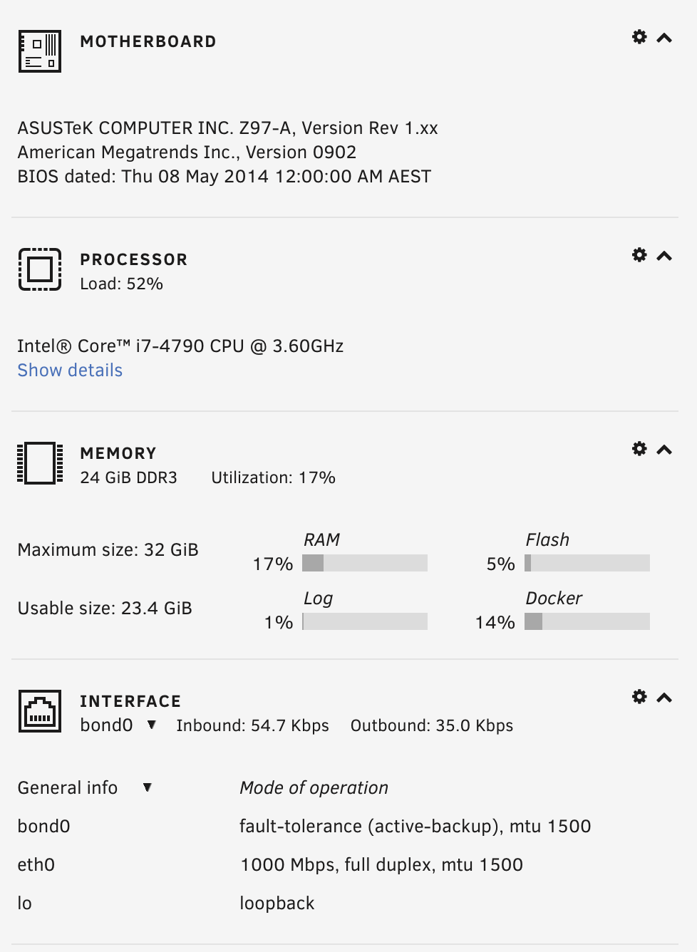

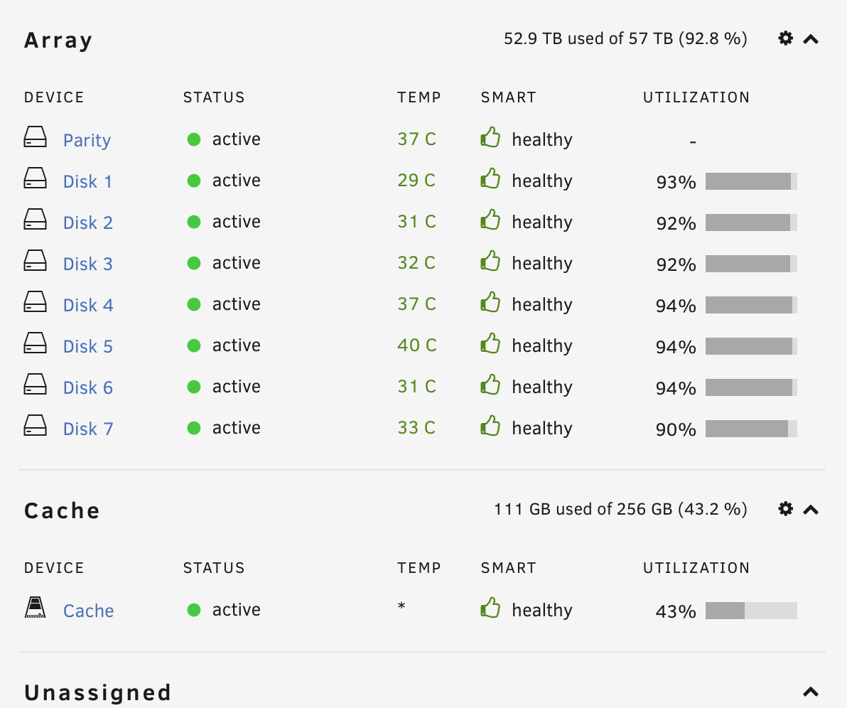

So I currently have a Plex unraid pro server but it struggles to even do 3 streams/transcodes I need something a lot more powerful.
I seem to keep getting a bottle necking which I'm aware there are somethings I could try and fix with the current system but I really feel it would be better to build from the ground up to suite what is needed. I have a big family that travel for work and I want my whole family to be able to access the plex server on the go. We have all come together and brought all our media into one location so we can stream to all of us.
So we need the system to be able handle about 20+ streams and a good chunk of them would prob have to be transcoded to stop a internet bottle necking.
So I need a pretty epic build here.
I'm going to post some images from current system below but we need it a lot better than this.

My current system has about 10 drives in it, just adding another now altho the cache drive is not big enough and needs to be upgraded.
