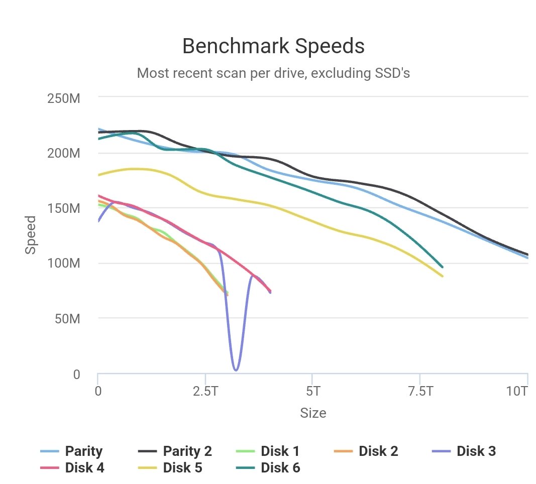

That's because it's past the 3TB mark, nothing on the log, you should run the diskspeed docker to see if al disks are performing normally.
Thanks Johnnie, am running it on each disk one by one now.
Yeah it does seem like disk 3 has some issues at a certain sector of the disk.
I guess for now I just have to wait it out and once its done with those  sectors the speed should pick back up.
Will try replacing the SATA cable but I don't think that'll help. It really looks like the disk had issues at a certain sector of a certain platter.
Yes, disk3 is likely the problem, for WD drives these slow sector zones can usually be seen on SMART on this attribute:
ID# ATTRIBUTE_NAME          FLAGS    VALUE WORST THRESH FAIL RAW_VALUE
  1 Raw_Read_Error_Rate     POSR-K   193   193   051    -    46077
This should be 0 on a healthy WD, and in my experience these slow sectors turn to bad sectors sooner or later.

Welp the raw value for that attribute is now at 68k and increasing.
And on unraid the read error count is at 9048 for that disk.
I don't think it's worth it to continue the Q calculation as it would most probably be not accurate for disk 3 in case a rebuild is needed anyway.
Would it be better if I cancel the Q calculation, reuse disk 6 (brand new 8tb with only 10gb data in it which I can move over to another disk) and do a new config with disk 6 as the new disk 3,do a sync using the P parity to rebuild disk 3, and then redo the Q calculation.
What do you think? And I think when I do that new config I won't even add parity 2 to the new config at first just to ensure it foesn try to do anything as its technically not readyto rebuild disk 3 array drive.

OK, IMHO these are the best 2 options:
1) let parity2 sync finish, it will take more time than normal but as long as there are no read errors on another disk at the same time as the ones on disk3 parity1 can correct the read errors on disk3, and parity2 will be valid once synced, then replace disk3 when possible.
2) use parity2 disk to replace disk3 now, to do that unassign parity2, start array, stop array, assign it as disk3, start array to rebuild.
P.S. disk2 also shows some read errors, but they were some time ago and it should be fine for now, but it's a good idea to monitor the raw_read_error_rate attribute, if it keeps increasing it will likely fail soon.
