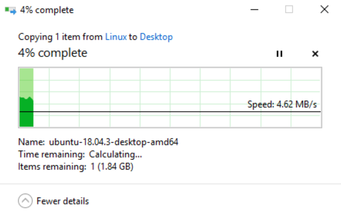

"Brutally slow" as in, if I'm seeing 4.5-5 megs, I'm stoked.
1063132603_2019-12-0510_19_49-QEMU(Controller)-TightVNCViewer.thumb.png.c3f2115d59f8b0618dc75b9b595ffa17.png
This is transferring a file from an unRAID share to the desktop of a VM.  Transferring from my laptop to a share is lucky to break a meg.
That's far from normal, you should get 40/50MB/s with default writing mode and line speed with turbo write, post the diagnostics, might provide some clues.

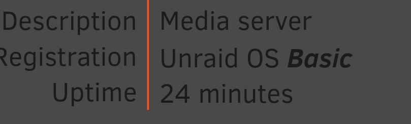

I haven't had an unclean shutdown.  Not that I know of.  The thing is in a datacenter...it should never be shutting down.  Ever.
Never say never.
Ask your datacenter provided what happened on Dec 6 at 07:54:55.
Even if nobody accidentally turns it off, your server (or server host) could have crashed - that counts as an unclean shutdown.

Hmm...well, wtf...
How is it rebooting but looking exactly as I left it when I log in?  My unRAID server at home just got unplugged on accident and it was completely dead until I went back in and restarted it.  Had to go back in and restart the array and all that.
Likely there is a setting in the BIOS that tells it to reboot after a crash or when power returns.

And, now that I know it's rebooting, I poke my head in from time to time and...yea...
It's DEFINITELY rebooting. Now...why? I have no idea.
