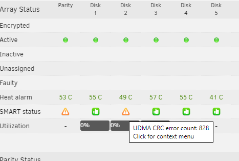

All drives recognised however my Parity disk and "Disk 2" are showing alerts.

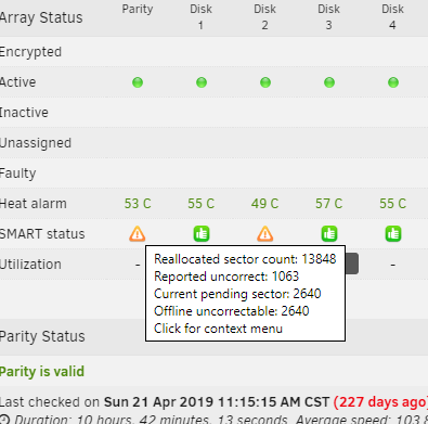

Parity Drive is showing reallocated sectors, etc.
Disk 2 is showing UDMA CRC errors.
Screenshots of both attached.

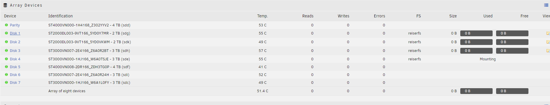

On top of that (i don't know if it is related?) the drive array is taking a very long time to start. I left it for at-least 30 minutes and it was still on Disk 4.
Also attached screenshot of that.

CRC errors are not Drive errors.  They indicate a failure of the CRC check of the data being transmitted over the SATA data cable between the hard drive and SATA controller where the CRC is verified to determine that there was no corruption in the transfer.  (By the way, this number is permanently stored on the disk and can not be reset.  Monitor to make sure it does not increase.)   It is usually caused by a bad SATA cable or a loose connection of the cable. The data on the disk is most likely fine.   The data will simply be retransmitted until it is received without failing.
You should post up a Diagnostics report      Tools   >>>   Diagnostics  so that someone can have a better look at the parity drive.  (Personally, I would replace the parity disk, rebuild parity on that new disk.  Then I would have a better look at the old parity drive to see what its issues are.  With the limited data that I see here, I would suspect that it is toast.)
EDIT:  By the way, 227 days between parity checks is much too long.  You should be doing it (at least) monthly.  If you had not done it, you should also setup the notification system and have it sending you status reports on the health of your server.

I would replace that parity drive immediately.  With over 13,000 remapped sectors  and over 2400 sectors needing to be remapped, it is a disaster  waiting to happen Even if you could get it to remapped those 2400 pending (and, apparently, completely unreadable) sectors to remap, when would the next one popup?  Probably right in the middle of a rebuild of another disk which would cause that rebuild of that disk to fail.
yup, will buy a new one tomorrow and fit it.
