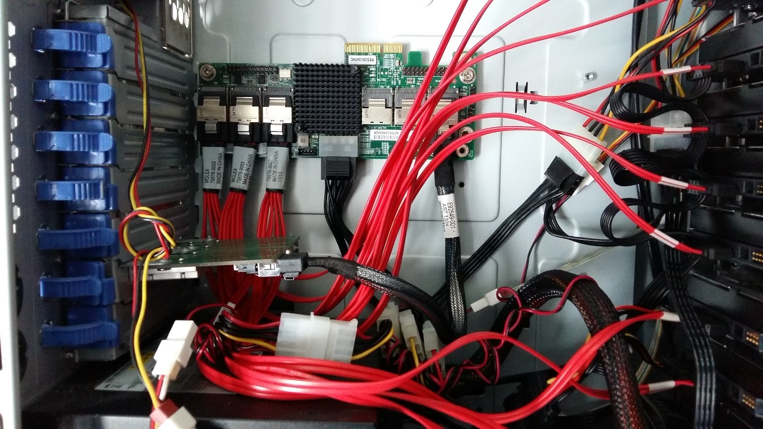

On 12/4/2019 at 2:53 AM, johnnie.black said:
You can use an homemade DAS, e.g.:
13 minutes ago, drugdoctor said:
Would this only be 1 cable going from Server to DAS?
You can use one cable for single link and two cables for dual link.
Also, can you please add give some specs and links your set up above.
On the main server you need one SAS HBA with external ports (or with internal ports and one SFF-8087 to SFF-8088 adapter).
On the DAS side (besides the normal hardware):
-SFF-8087 to SFF-8088 adapter
-SAS expander, I use the Intel RES2SV240
-SFF-8088 to SFF-8088 cable to connect DAS to server, because of the expander it can be up to 10 meters long even with SATA disks, but use one as small as possible (expander to SATA disks cables need to be 1 meter max ).
