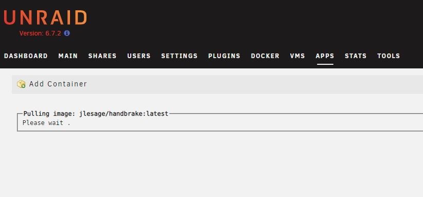

I have not been able to install apps (dockers specifically). Plugins install fine, but not dockers.
The installation stops with "Please wait...." and nothing follows after (as shown in timageproxy.php?img=&key=e5eec7c5c933ca16he attached image).
Please assist and thank you :)

Same problem here. Can`t update dockers, get stuck on `please wait...` like in the picture above. Happened today, haven`t done anything to the server lately. However updated from Unraid 6.6.7 to 6.7.2 just now, hoping it would fix the problem, which it didn`t.

UNRAID does not seem to accept these two IPs. When I put these two IP in the DNS field under Network Settings, UNRAID says these are not proper IPv4 IPs.
Because I typoed them (too many 2's)
208.67.220.220 & 208.67.222.222

I am having the same issue, adding the DNS servers did not help, any ideas?
This one was my bad i think, my pfSense runs as a VM and i had one DNS.... pointing to pfSense lol. Changed it to Googles DNS and its now working.
