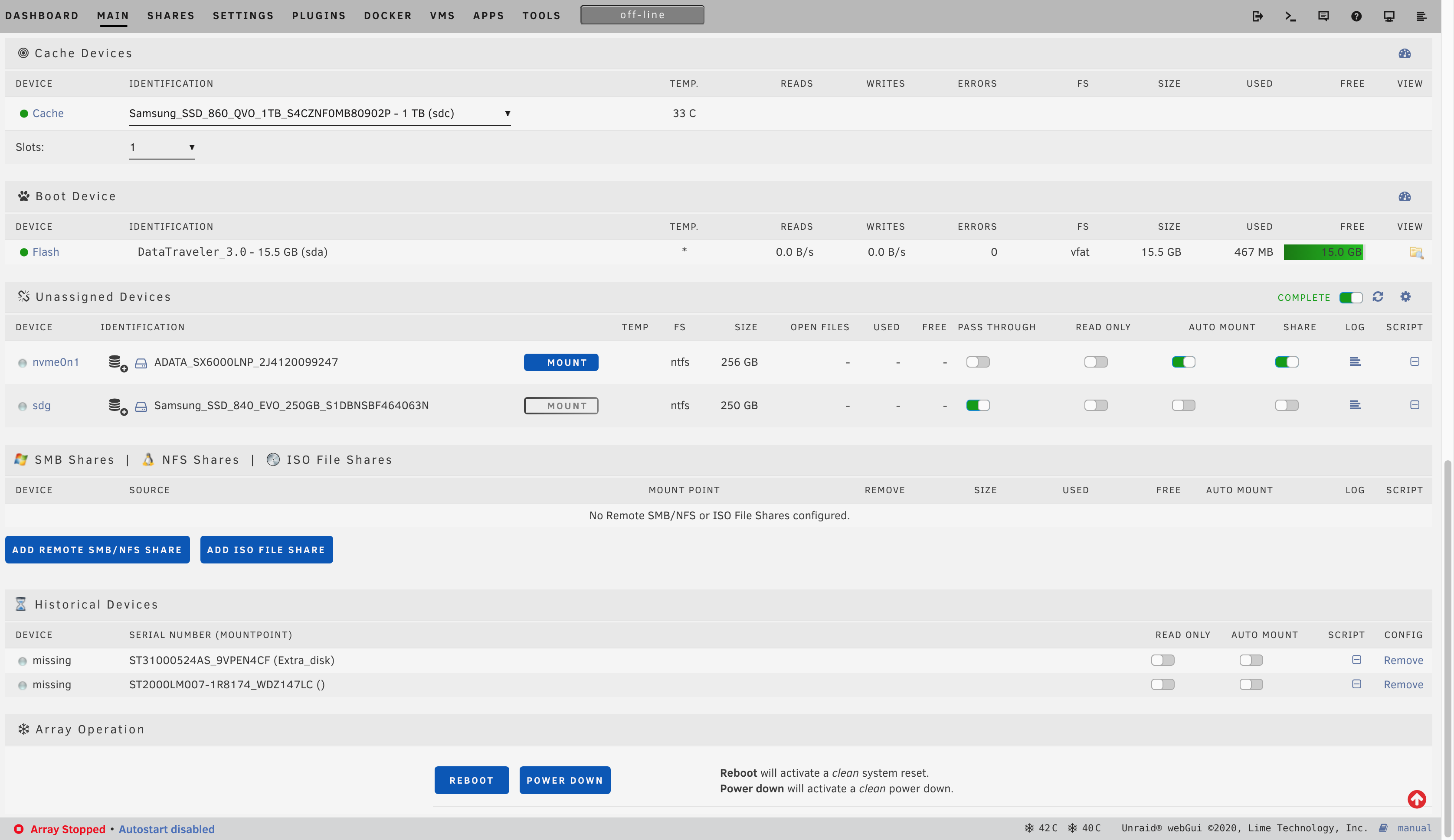

Same error here. I switched out an unassigned HDD for an SSD and in that process I acidentally unplugged my parity drive. Started up the server and realised. Shut it down, plugged the parity drive back in and restarted. The parity drive is now back but the array start button is missing. See screenshot and diagnostics.
monsterservern-diagnostics-20200321-1351.zipscreenshot1.thumb.png.9e975288703d30ff81170a7c6d7ef901.png

Try rebooting and start it in safe mode from the boot menu to see if that makes any difference.
Hi! I rebooted normally (just like someone else in this thread) and the start button is back. Just wanted to post my diagnostics in case someone was interested in investigating this bug.

I've started having this problem too after the system crashed due to a kernel panic.
However, I was able to restart the array by using the 'play' button you find on the Dashboard screen - above the case icon in the top left, where you also see 'reboot' and 'shutdown' buttons.
In cases like this, Main is where you want to be as there's more information on it.

Happened to me as well just now, after a reboot cause one NVMe drive was reported missing (but BIOS saw the drive, this has been happening from time-to-time with the Asus Hyper M.2 V2 Gen3 card for unknown reason).
To get the START ARRAY button back I did what was suggested by @jagz707
I clicked the play button in the Dashboard, but the array didn't start cause I have it encrypted.
I then went back to the Main page and all the bottom buttons were there and was able to put the passphrase and start it up.

Happened to me as well just now....Just added a second parity drive, all went well.
Went to start the array and no "start" buttons - just "reboot" and "shutdown"
I clicked the play button in the Dashboard and all started.
Stopped it again. Start button gone again. Tried a few other things and then rebooted and things seem normal.
