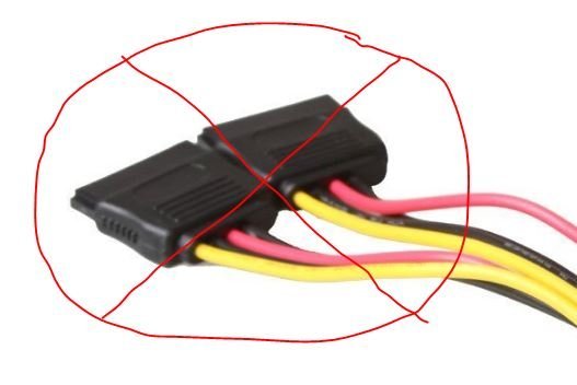

If powering 3.5" HDD then I would use the MOLEX -> SATA since I don't want to overdraw current on a single SATA cable (which can happen if multiple HDD spins up simultaneously).

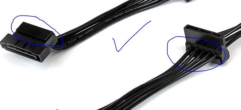

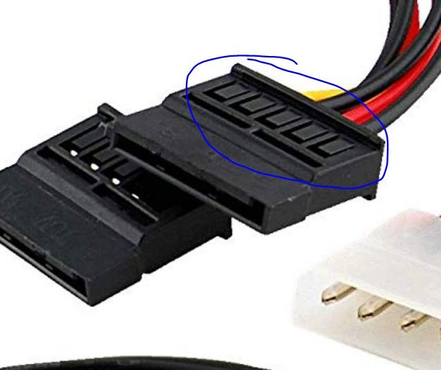

Don't use the molded style, make sure they're the punch down type
Thanks! Any idea if this type will work?
