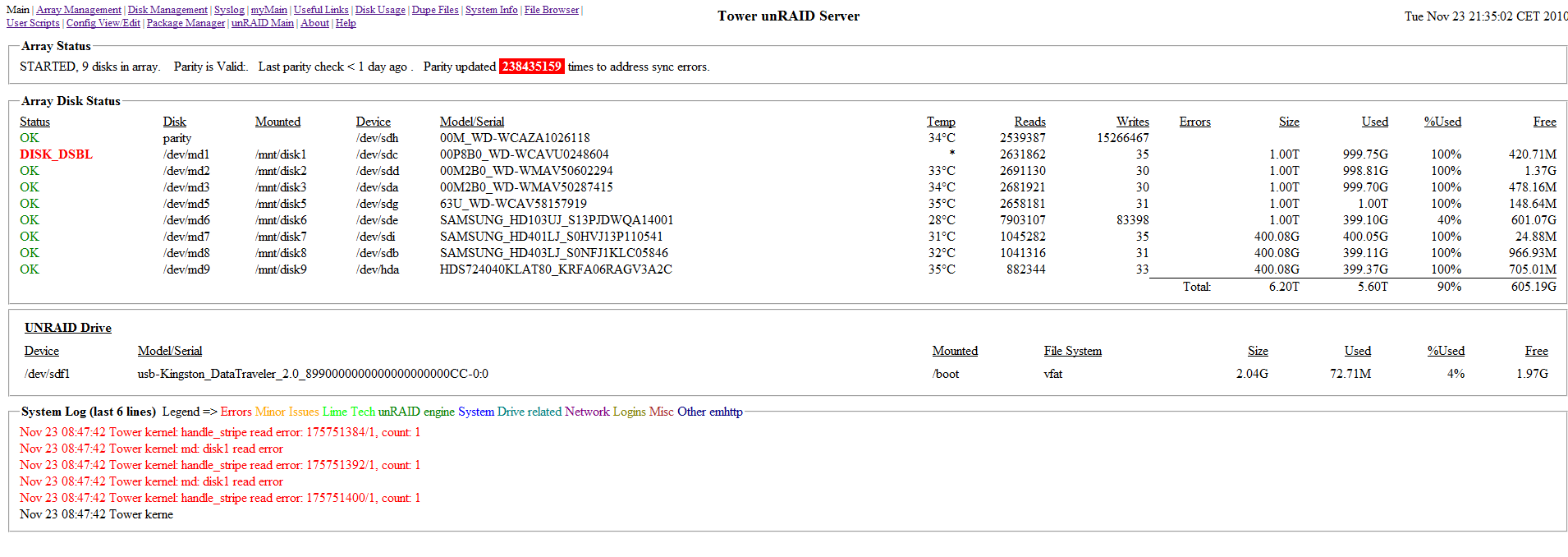

I was doing the swap-disable as documented here: http://lime-technology.com/forum/index.php?topic=8569.0 and when I left the system this morning, everything looked fine.
When I got back, the server looked like the attachment, and I got a 2GB Syslog (NOT attached) that essentially contains information like this (the "sd..."-lines are much less frequent than the handle/md lines):

It seems that the regenerated disk6 (accessing it from it's disk-share) has only a very small fraction of the original data on it.
Also the disk1 appears empty, even if the folders are there.
Initial spot checks indicate that data on the other disks appear intact.
My original disk6 is obviously also still intact.
I really need some advice on how to proceed. Please.  :'(

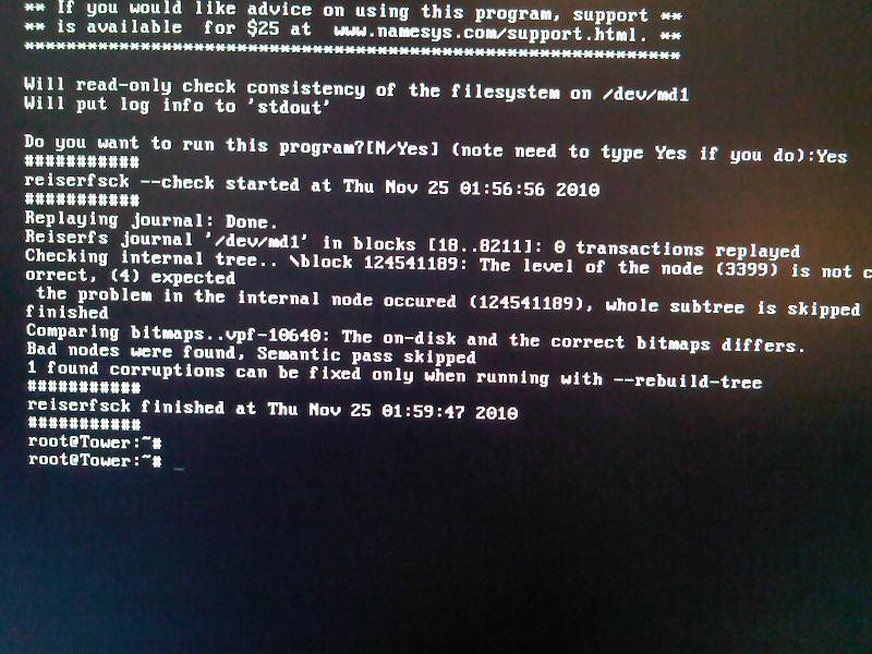

Get a SMART report on it.  If it looks good, then a reiserfsck of it would be in order.
What I read from that is that I would activate the "File System Check" button on the "Disk Management" screen?
I guess it is the commandline version. But which parameters are to be applied?
The reiserfsck --check /dev/sdc stated thath the superblock is corrupted, and that states that I should run the --rebuild-sb paramter.
Is that actually what I should do?
You always start with just the basic command.  If an additional option is needed, it will tell you.
So, since this is disk1, if the array is able to be started, you would type
reiserfsck /dev/md1
to perform the check.
If the array cannot be started, then you'll need to use reiserfsck on the actual physical disk partition but that will invalidate parity so let's wait on that first.
I did this on the console, but it did not end up in the syslog (which I'm attaching anyway, since I have started the array in the mean time)
So I made a photo of the console in stead.
It essentially states, that i should run --rebuild-tree
Should I?
syslog-2010-11-25-reduced.zip
Yes, that is exactly what you should do.
