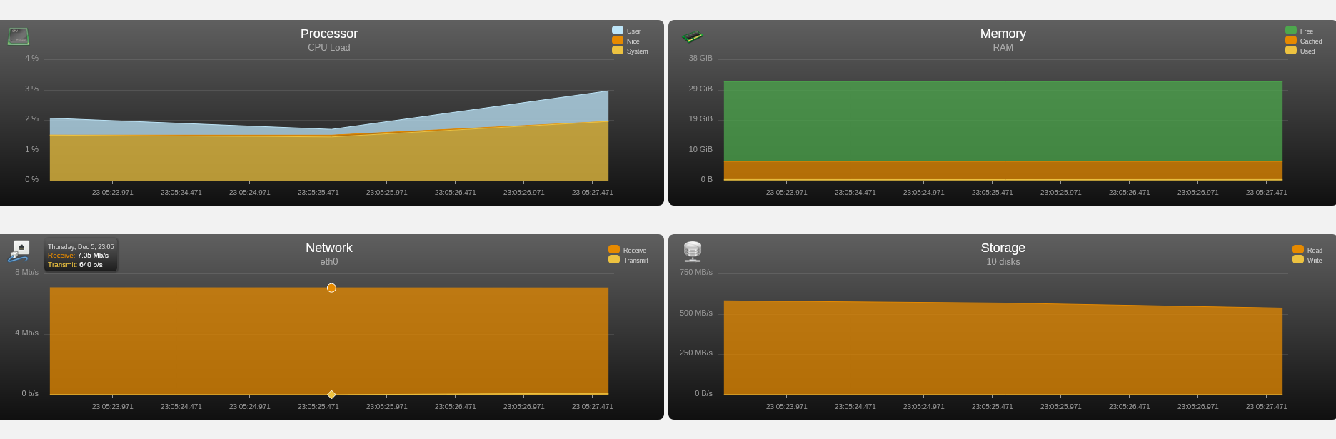

7.2 mbps of unexplained incoming traffic.
No discs are being written too.
I haven't set up any copy jobs.
Nothing on my network is uploading at anything close to those speeds, not even totaled.
To the Unraid server or otherwise.
And i even blocked the server from accessing the internet on my router.
Turned FTP off, stopped all dockers, removed read permissions to shares. Still the same steady incoming 7 ish mbps.
I am running the pre-clear plugin, so i would rather not reboot.
And i assume that the pre-clear plugin should not cause incoming traffic on an Ethernet port.
Maybe i am missing something super obvious and i'm just and idiot.
But i don't understand what is going on here.

Edit: It stopped After doing this constantly for at least 1 hour and 10 minutes.

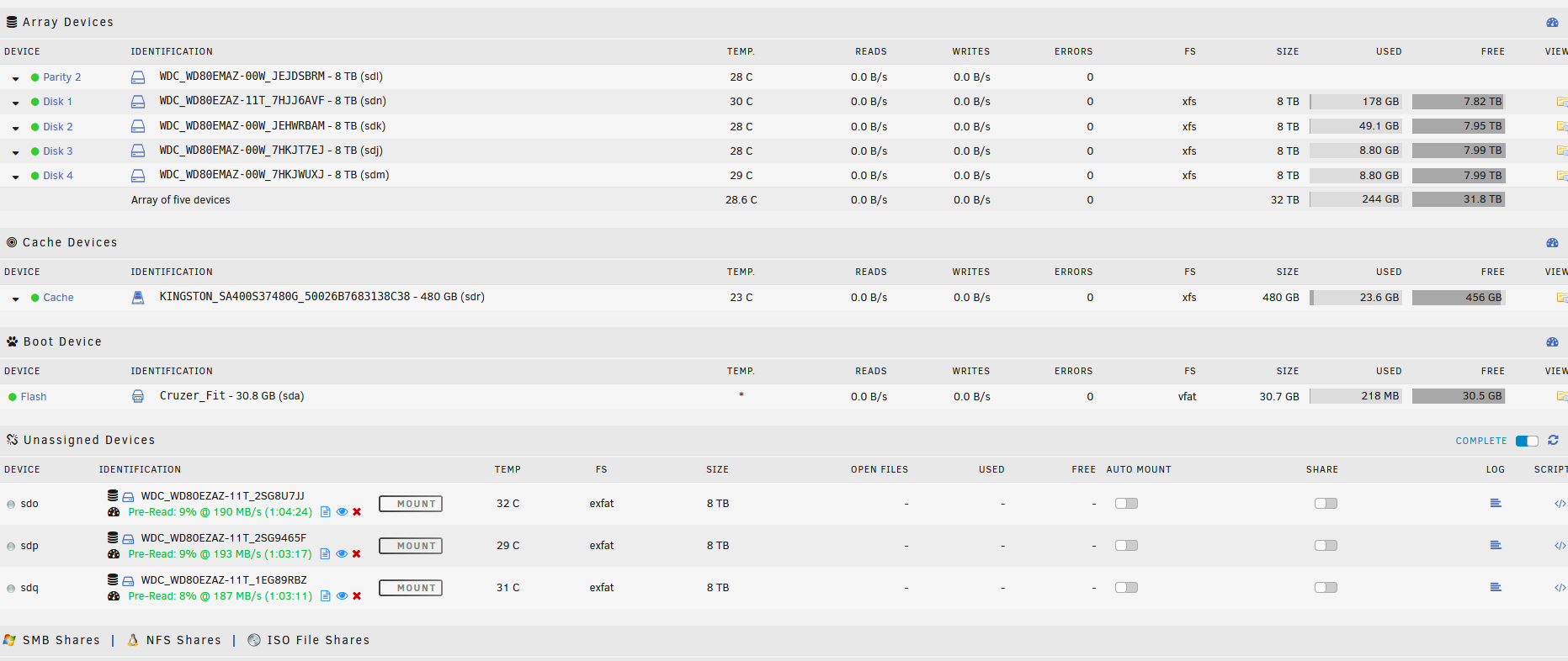

From your screen capture of the Main tab, nothing is being written to any device on the array.  (I am assuming that it was taken when this activity was going on.)
Now, 7.2Mbps is not very fast (for a data transfer).  I would suspect that it is GUI activity.  Did you have more than one GUI screen open?  Were you 'watching' the preclear progress on those three drives?

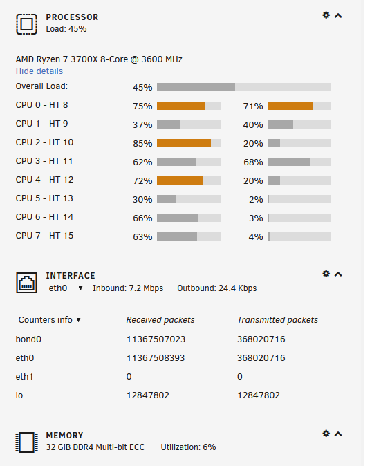

I just noticed that bond0 is my ipmi interface on my Asrockrack X470D4U mother board: https://www.asrockrack.com/general/productdetail.asp?Model=X470D4U#Download
bond0 and eth0 are both listing the exact same numbers . But they do have different mac addresses and the system has 2 cables hooked up.   So this is perhaps just related to the impi/kvm, some weird internal traffic?(sorry didn't think about mentioning this sooner)
I thought bond0 was some ''unraid thing''.
 For the record i was not using the ipmi/kvm functions and it still showed the constant 7.2 mbps inbound activity, also the kvm function won't work at the moment for some reason ('' powered off no signal'').
And just now  it seems the speed dropped again to 30/40 kbps inbound on both bond0 and eth0.
Weird...
