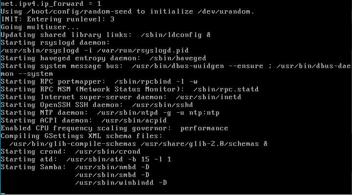

It does not go past Starting Samba (see screen shot). I let it sit for about 30 min. It is not locked up as I can do a graceful shutdown from my kvm and it shuts down correctly.
I tried removing those plugins and still get the same result.
Attached is the mirrored log.

Looks like thats a diagnostics generated when shutting down, not the mirror of the syslog when rebooting.  Should be a syslog.txt file in that folder
Sorry, new to the syslog stuff.
syslog
IDK, since it works in safe mode, I'd delete all the .plgs from the folder (except for Community Applications), then reinstall them one by one with a reboot to see what is causing the problem
