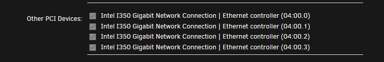

Now for pfSense.. It does not want to read the i340-t4 or the i350-t4 card. installation is smooth, but after the reboot it boots fine but it does not find a valid network interface so it halts and waits for a shutdown. Both the cards i use i hear all over the place is best/good and works fine with pfSense. Here i need some guidance because if i do the exact same thing for windows or Ubuntu it works the second it boots so here i'm at a loss..
Just to clarify i use vfio-pci.ids=(id of the network card and add the card under available devices in the VM) in flash under syslinux configuration after "append initrd=/bzroot". so it looks like this "append initrd=/bzroot vfio-pci.ids=8086:1521" and before someone yells it needs to be between append and initrd=/bzroot i have tryed this too with no success on pfSense and it didn't seem like it was any difference in windows or Ubuntu. I have also tryed to set the network card up as a virtual card for pfSense also since someone said it had the vfio drivers, but this did not work either. the weird part is that if i do it with the motherboard NIC's it works (done the exact same as i did with the i340 or the i350) and those are realtek.. read so many threads that realtek cards does not work well with pfSense so i got surprised.
Any help would be appreciated and if you want me to check something please add how to do it as well so this prosess will go easier. if your wondering about anything dont hesitate to ask, i will provide everything i can.

Please could you take a screenshot of your pfsense vm settings like  the one attachedpci-unraid.PNG.f33e9c1fcedaa001af7b49ea49f80d17.PNG
And just so you know, I think the latest pfsense requires you use "OVMF" bios.

As for for pfSense i have tryed both SeaBIOS and OVMF with no luck. I stubbed the network card with the command vfio-pci.ids=(id of the card, I don't remember what it is now). I got the same result you have in the picture. I tryed to just focus on the windows 10 vm now so pfSense is not configured on my server now.
I downloaded the manual for the motherboard i have. Any pointers for where i can find hardware passthrough? If you see in the picture in my first post I have HVM and IOMMU enabled. So passthrough and virtualization should work, but i'm just getting started so i'm not qualified to say anything about if it should be working or not..
