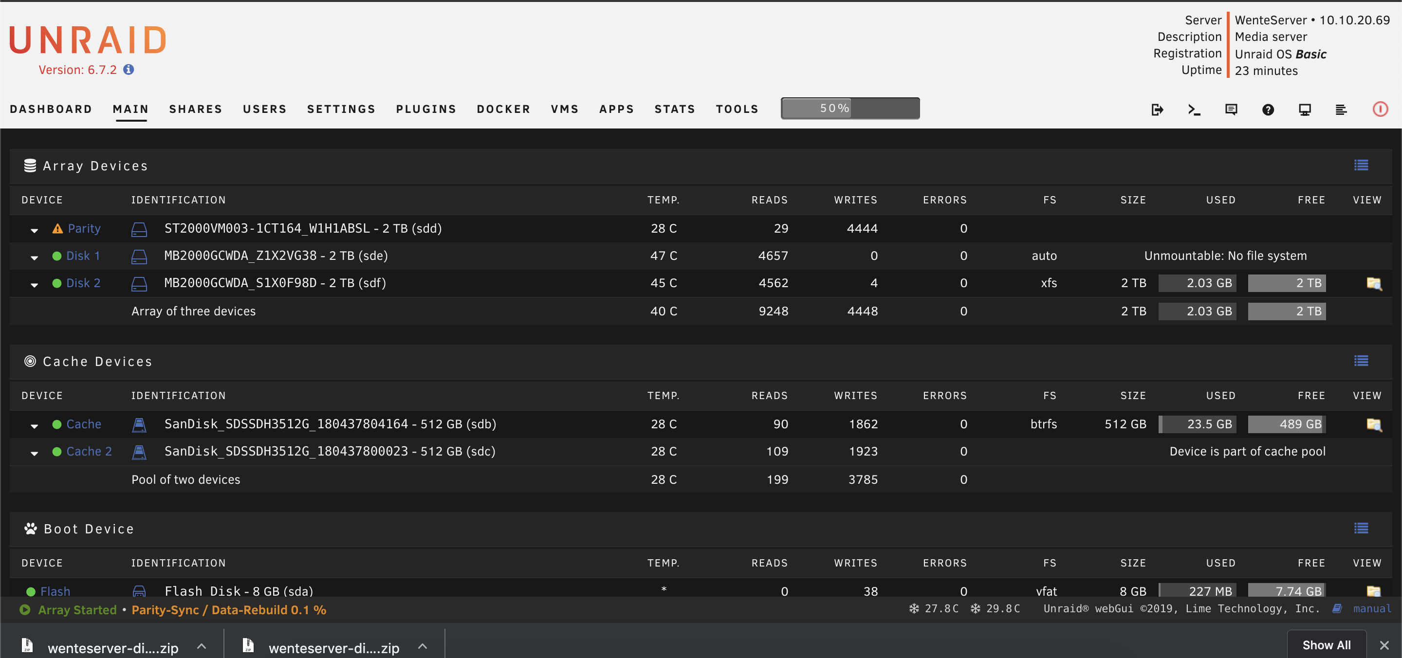

Post a new set of diagnostics.  That doesn't jive with the one you previously posted

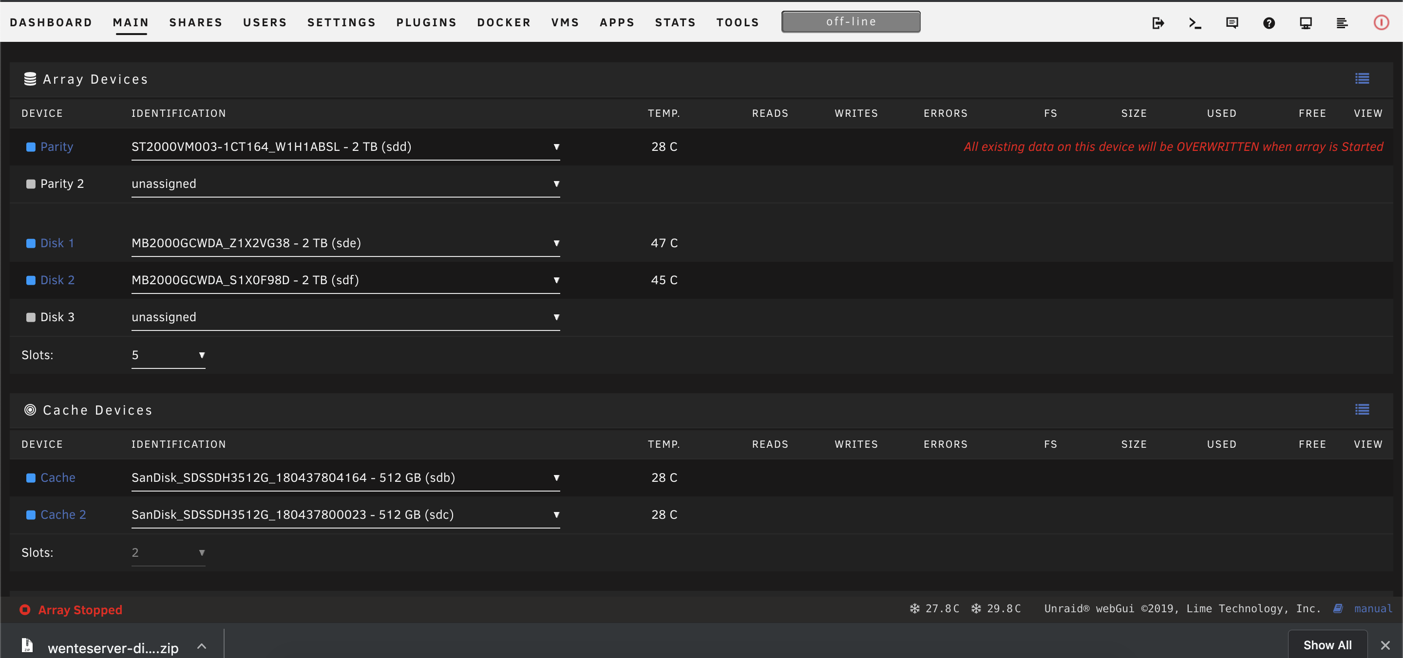

That screenshot doesn't agree with your diagnostics. Did you do anything between taking the diagnostics and taking the screenshot?
That diagnostic doesn't agree with your screenshot either, since it doesn't show any disks mounted and in fact shows them as both newly assigned.
Are you messing around trying to fix this by yourself? Stop!
Post a new screenshot.
Basically the above, but when we're trying to help and look at diagnostics in relation to the screenshot, don't do anything.  And it looks like you've definitely stopped the array but the screenshot shows that its not.
Restart the array, and post a screenshot and a fresh diagnostics

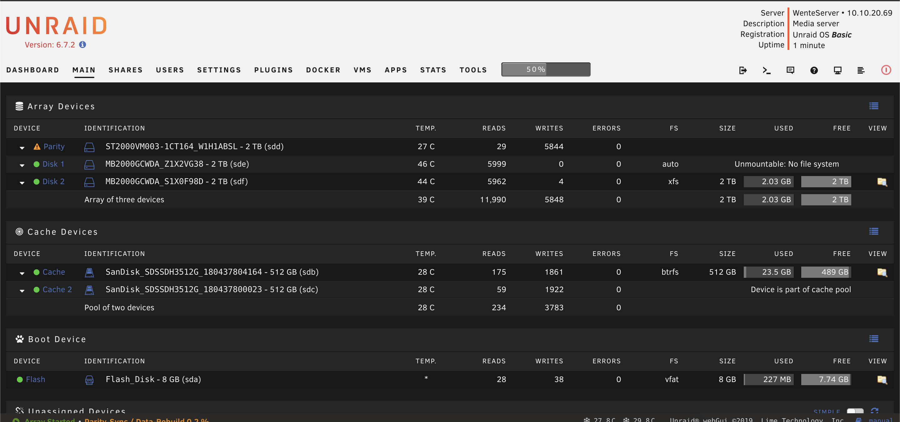

Also, in Unassigned Devices, disable any drive attempting to automount.  It's messing crap up in the logs and confusing the issue.
1540938177_ScreenShot2019-12-08at12_42_07PM.thumb.png.6ea977c6fe4c97eb61c03fb9952457a2.png
