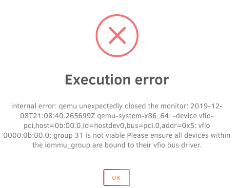

Unfortunately I did a force shutdown and I could not start the VM anymore and the log quickly went up to 100%. Extending the log from 128mb to 512mb does not help, as it quickly gets full after another VM startup. Only a server reboot helps to clear the log files.
438302162_Screenshot2019-12-08at20_27_04.thumb.png.b5b00101211eee5f2a9d2107330be0f9.png

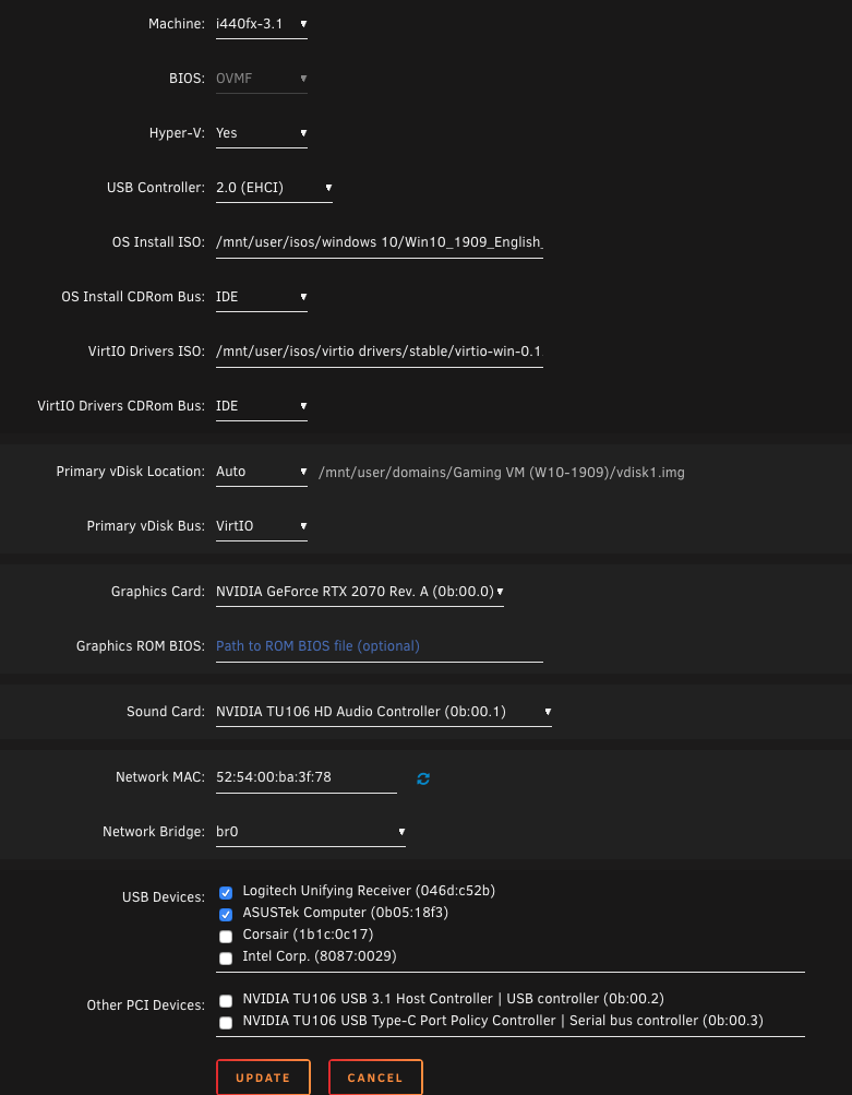

Since the graphics card has an USB-C port, I've added the usb-c & serial bus controller ID to the syslinux config as recommended in a video.
As you can see in the picture, these 2 also appear in "Other PCI Devices"
10de:lada
10de:ladb
1373133208_Screenshot2019-12-08at20_28_04.thumb.png.aeaf29df760e03efc8da523c653dcc98.png
2083069918_Screenshot2019-12-08at20_28_33.thumb.png.209581f22365cb63ebeb64847b0bb96b.png
Although I can attach the graphics card and the sound of the VM, but I can not start it anymore. The 4 attached CPU cores and log is running at 100%

If you pass through the USB and Serial controllers to the VM (check the ' other PCI devices' boxes), will it boot?
If you remove the USB and Serial controllers from your syslinux, will the VM boot?
Is there anything in the log file that's repeating over and over that causes it to fill so quickly?

If I remove those syslinux entries and reboot the server, I get this message ->

@MihaelInterestingly it looks like the USB controller of some 20xx series cards is causing the same reset issue like some AMD cards show for a while now. The usual fix is to not passthrough the controller and not connect anything to it. I remember 2 users now which had issues with it and this fixed it for them but I can't remember if they stubbed the devices or not. If you append them to the syslinux try to add all devices from the card and not only the 2 controllers to prevent unraid to initialize the whole card.
