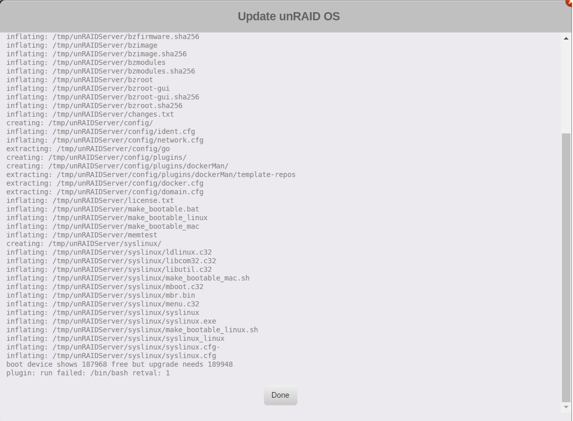

I tried to update unRaid to the latest version (it's now 6.5.2), I received the following message (see attached log):
boot device shows 187968 free but upgrade needs 189948
plugin: run failed: /bin/bash retval: 1

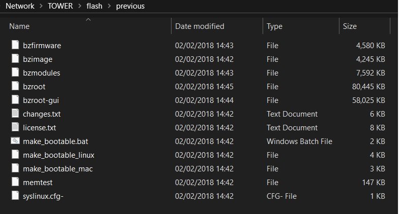

I saw that there's a directory, Previous, that has more than 150KB used (see attached), can I delete some files from this Previous dir so that the update will succeed?

A larger USB flash drive is almost free these days. I'd not worry about what you can delete but first update to a larger USB instead of trying to circumvent the normal update path.
What size is your flash drive?     Sounds as if you need a larger one.
The ‘previous’ folder is where Unraid puts the release that you are currently running as part of the upgrade process from the GUI and it’s contents will be recreated any time you try to run the update from the GUI to allow for reverting to the previously running release.
you can update manually by downloading the ZIP file for the release and extracting all the bz* type files to the root of the flash drive.   When doing this you can delete the ‘previous’ folder and it’s contents as that folder is only used to support the option in the GUI to revert to the previously running release.
