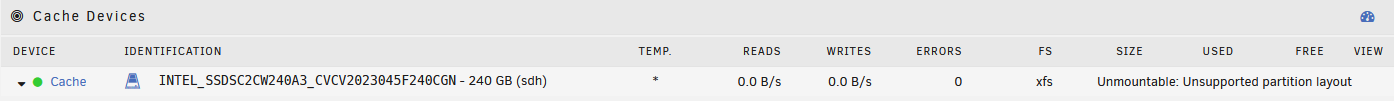

So a couple days ago I encountered fs corruption on my cache drive.  Restarted the array in maintenance mode, ran xfs_repair, got things going again.  Didn't think too much of it because the smart report on the drive appeared good.  Today I wake up an my dockers aren't running, looked like something similar happened, so I stopped the array rebooted and was welcomed back with the "Unsupported partition layout" error on my cache drive.  image.thumb.png.dbd3213869bb860f26b26cffb39adfa9.png

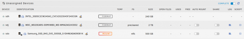

Looks to me like there's simply no partitions on that drive anymore:
At the moment, I've got another drive standing by in the machine ready to be a new cache drive, but my question for the group is, is there anything I can do to recover what was on the cache drive?  I'd made the mistake of not installing the CA Backup Appdata plugin, so otherwise I think I'll have to go reconfigure all my dockers :(
Any help would be appreciated.  Array is sitting in maintenance Mode at the moment and I haven't done anything to the offending Cache drive.

That error would imply something changed in the MBR or the partition layout making it a non standard parition, that should never happen in normal use, but if that's the only problem it should still mount with the UD plugin.

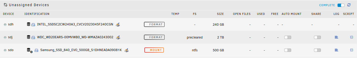

I installed the UD plugin, and when I stop the array, remove the Intel/sdh from the cache slot, it shows up in the UD section, but does not appear to be mountable:
Looks like the partition disappeared, so probably data it not recoverable, at least not easily.
Yeah, that was kind of my fear, was kind of hoping I was missing something.
Unfortunately yes, I missed that in the fdisk screenshot because it looked to me like you were cutting that part.
